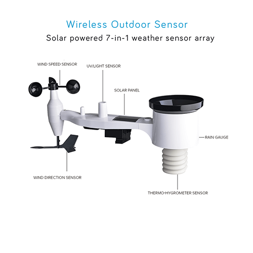

Im using this
galfert
Posts: 326
Location: Orlando, FL
Re: Ecowitt GW1000 and Meteobridge
Post by galfert »
That is a WH65. Same as what I have. Try to re-register sensor in WS View app.

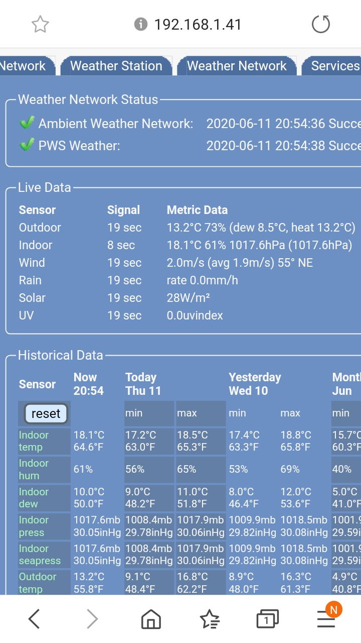

Re-registered the outdoor WH65. Still no rain.
Then I disabled all sensors in the GW1000 except the outdoor WH65. Now the rain data is back. So, the problem must be with having all the other sensors in use. Maybe a sensor is causing problems, maybe I have too many sensors for the meteobridge to handle.
Outdoor WH65, 8x temp/hum, 4x leak, 1x PM2.5 and a lightning detector. Now I'll start to reintroduce sensors and see what happens.
Screenshot_20200611-205500_Samsung Internet.jpg (368.45 KiB) Viewed 5387 times
_John C
Posts: 43
Joined: Thu Jun 11, 2020 5:31 pm
Post by _John C »
Ive discovered that the no rain data issue is caused by the WH55 water leak sensors. When I disable the 4 leak sensors; the meteobridge can read rain data from the GW1000. If I re-enable any of the leak sensors; the rain data cannot be read by the meteobridge.
