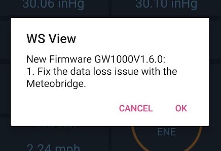

It seems that after upgrading to GW1000 firmware 1.5.9, I have random gaps, All gaps are 15 minutes long and I can have up 10 gaps a day.

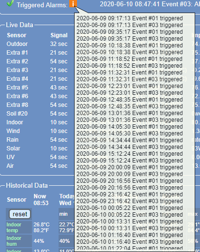

Same issue here.
GW1000 v 1.5.9
MB 4.3 (Jun 8 2020, build 3100), FW 1.3

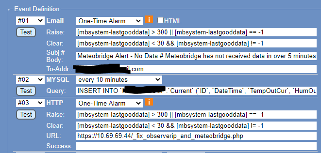

MB just stops receiving data from the GW1000 randomly it seems. Sometimes I have to fix it twice an hour, sometimes it will work for 3 or 4 hours straight without intervention.
Mine fixes itself, because I used to have an ObserverIP that always needed fixing and I left that logic in place for the GW1000. But getting alerts about it is very annoying.
If it helps any for Boris, you can "fix" it when it happens by restarting the logger process on the MB. (/usr/bin/rcloggerd restart)

galfert
