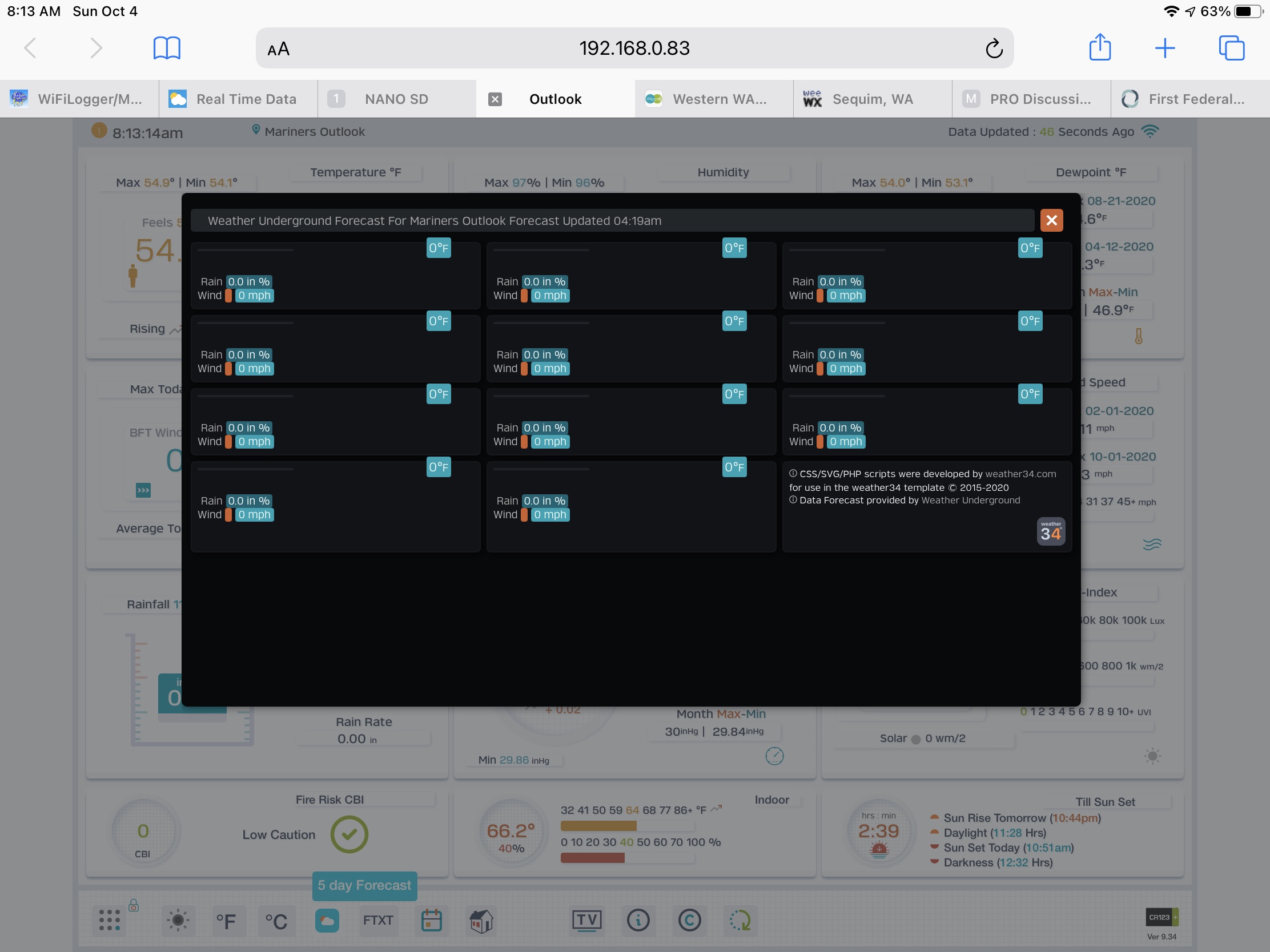

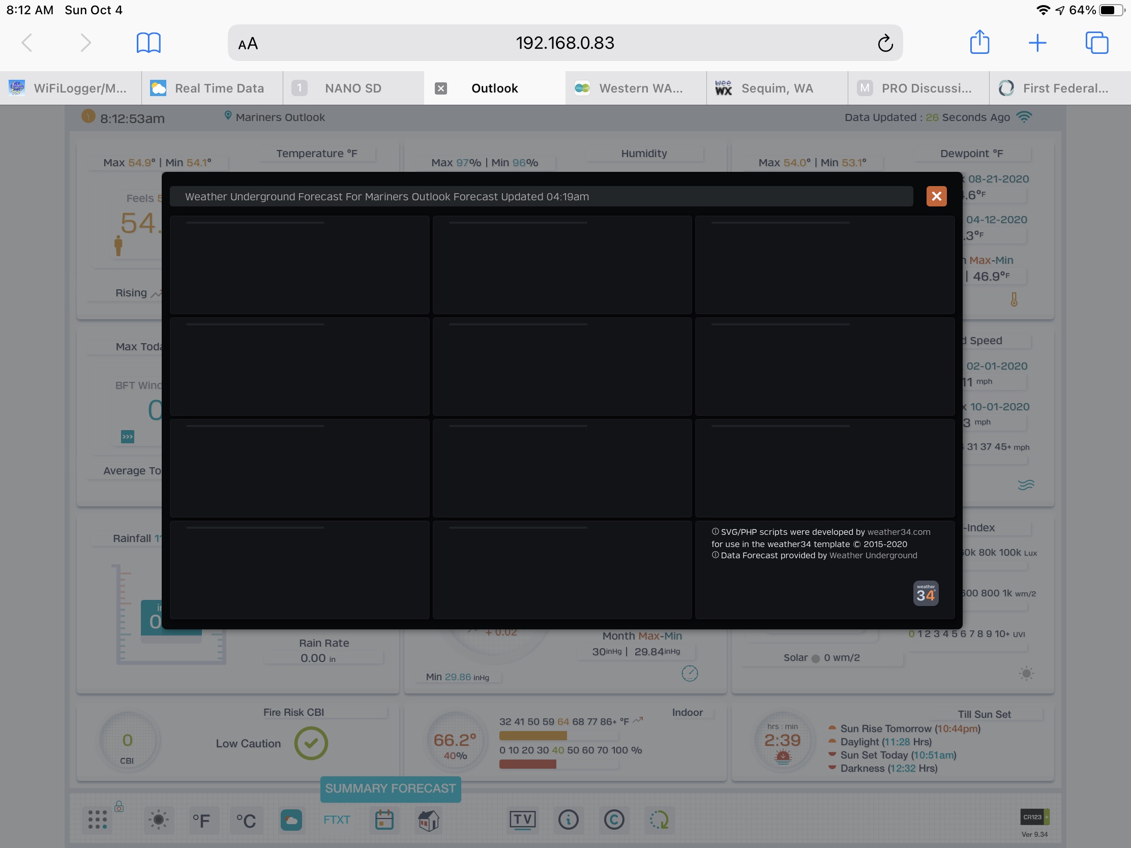

I followed Boris’s instructions to load the most current version of the dashboard and it works fine. I do find that the Wunderground Forecast doesn’t load at all, I just get a blank screen when trying to show it. I’ve gotten and inserted a new Wunderground API key in the Nano SD Weather 34 Dashboard settings. Looking at my Wunderground API useage it shows a straight line of errors. Anyone have the same issue or is it related to the 2021 termination of the forecast API ?.
Even more confusing is that if I load the original dashboard version ( you can view both of them ) the forecast is displayed correctly.

BigAlT wrote: Sat Oct 03, 2020 12:56 am I followed Boris’s instructions to load the most current version of the dashboard and it works fine. I do find that the Wunderground Forecast doesn’t load at all, I just get a blank screen when trying to show it. I’ve gotten and inserted a new Wunderground API key in the Nano SD Weather 34 Dashboard settings. Looking at my Wunderground API useage it shows a straight line of errors. Anyone have the same issue or is it related to the 2021 termination of the forecast API ?.
11816721-EE5C-46E1-98E2-909C312A9EB4.jpeg76FF5676-A4AA-4A5F-A3FF-391598628205.jpeg975B2E43-0A9C-4929-BDA0-4EAF4FE376E0.jpeg
Same with me. Running build 3470

As a matter of fact, my api key is setup but forecast are NOT related to my location. Forecast is correct using PWS. Yes I'm using the same API for other purpose. This is why I may say that forecast is totaly wrong using PWS2

I finally got the WU forecast working. First, I was using an api from another WU Station ID which I had created earlier. After getting a WU api for the correct station ID which I was using for WU on my Nano SD and copying it to the Weather 34 new template settings page and saving it, I went to the Weather Dashboard tab under the Live Data Tab. I checked the feed Dashboard with Data Box, hit the save button and then hit the launch dashboard button. Both the current forecast and 5 day forecast work as they should.

As you did, I hit the launch dashboard button after setting the API key and forecast is displayed correctly
