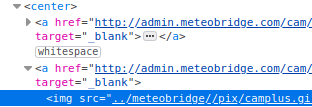

This is interesting. On Firefox and Chromium for Linux I did an inspect for the Meteobridge camera link and it doesn't have https:
That accounts for my confusion in this whole matter.
