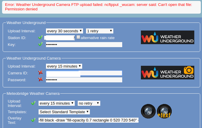

This give me a green check on the weather cam page but in Wunderground Camera I get:
Error: Weather Underground Camera FTP upload failed: ncftpput _wucam: server said: Can't open that file: Permission denied

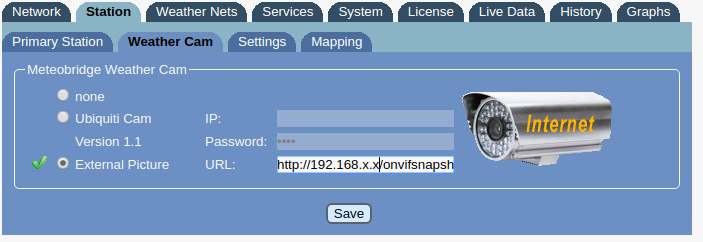

Forgive me for being rather dense but something just isn't 'clicking' for me. WeatherUnderground is expecting a file named image.jpg
Screenshot from 2020-10-16 16-51-26.png (43.97 KiB) Viewed 3577 times
URL is http://192.168.x.x/onvifsnapshot/media_ ... &subtype=0
If I put that address in my browser I get an image
Screenshot from 2020-10-16 16-54-09.png (68.64 KiB) Viewed 3577 times
When I click on the camera icon I'm directed to http://admin.meteobridge.com/cam/<is this a secret>/cam.jpg
When I click on the camer icon +text ahttp://admin.meteobridge.com/cam/<is this a secret>/camplus.jpg
Both show a message "The connection was reset"
You mentioned FTP service do I have to fill this out too?
Screenshot from 2020-10-16 17-02-04.png (23.06 KiB) Viewed 3577 times
Or perhaps here?
Screenshot from 2020-10-16 17-00-05.png (8.45 KiB) Viewed 3577 times
If I have to do this too what's the point of the Wunderground Camera service?
Still trying to find that manual. For a $300+ device there should be a bit more explanation. This is supposed to be the 'easy' stuff.
