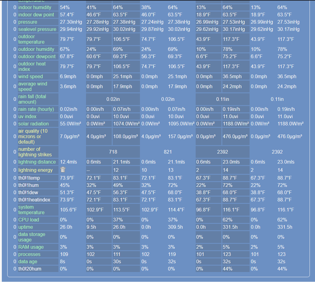

718 lightning strikes in the last 90 minutes and MB Pi is reporting 0 to Meteotemplate. Mapping is correct in MB. I really do not understand why MB thinks that lightning is nothing important and refuses to fix this. FFS, the iz0qwm / ecowitt_http_gateway that is TWO YEARS OLD can report lightning!
I 1000% regret ever giving MB one penny of my money.
- minmax.png (137.24 KiB) Viewed 5551 times
Meteobridge VM | GW3000
- Posts: 1826
Re: GW1000 + WH57 lightning sensor only - Lightning not showing in MB
please look at your screenshot it is reporting lightning , perhaps your issue is meteotemplate not having the correct api string .
to find out what that should be is simply done by clicking on the number of lightning total and a tooltip,will appear with a string . once you have established what the string is then simply send that too meteotemplate dev and they can add that on to,the existing api output . this is how we established to use a weatherflow lightning method ,boris did his bit it was upto us to work out how to use that data . note also if possible make the lightning sensor a primary sensor ,not actually owning one ive no idea of what would appear . fwiw i have been liasing with a ecowitt user for a week or so but unfortunately im away for another 10 days without access to anything meteobridge. im sorry but Boris has done his part and your meteobridge device is reading the data from the lightning sensor as per your screenshot then it is now upto the template devs todo their part.
I think Boris got the message and is aware that something needs to be done for the remaining lightning issues to be solved.
As for Meteotemplate, I think two things need to be fixed - one with Jachym at the Meteotemplate (MT) end to adapt the database schema to today's needs as far as Ecowitt sensors are concerned. Then the "normal" API string for MT can be fixed.
FOSHKplugin doesn't - afaik - use the official MT API, but an interface (plugin) created by one of our Italian friends. That also works display only but is not an official interface supported by MB. Hence I think it's not fair to compare. This unofficial MT plugin circumvents the API string and provides data for which there is no place (yet) in the database schema for temporary display without archiving.
If this is not so, I'd stand corrected.
That's why I created my own http string, which is accepted by the MT API as long as data is sent for which fields exist in the database schema.
You can also send data to a plugin, but you have to define this yourself - and you can do this with MB and/or with the FOSHKplugin.
Still the official MT API support should be corrected. But it won't solve the problem that the MT Ecowitt plugin from Raffaello only displays values which are not in the database schema but doesn't store them. That part Jachym as the owner of Meteotemplate has to provide.
So we shouldn't compare apples with pears. Boris/MB only claims to deliver to the MT API, not to the Ecowitt plugin.
You can blame Boris for an incorrect or incomplete API string in the weather networks, but not for the missing corresponding database fields.
His string should contain the L= parameter, and someone will have to tell him which sensor to send with the L= parameter:
lightning_total, lightning_energy, lightning_distance - and he will take what the owner of the API (JAchym) says. And as far as I know Jachym hasn't said anything here yet.
If there were (resp. as soon as there are) database fields for the lightning distance (which are not there now at MT), they/it should also be provided by the MB string sent to the MT API.
important to understand boris will only add or change the API for a specific network or template based on request from the dev ,he wont change based on his own assumption because thats how things break if there is no communication between himself and the dev.
kd7eir i can tell from your previous screenshot of mb history that its no brainer to have your lightning data displayed on your website ,i reiterate the template dev needs todo his part and communicate this to boris.
im sure sooner or later this will be all working just hope its a universal solution not a specific user case.
