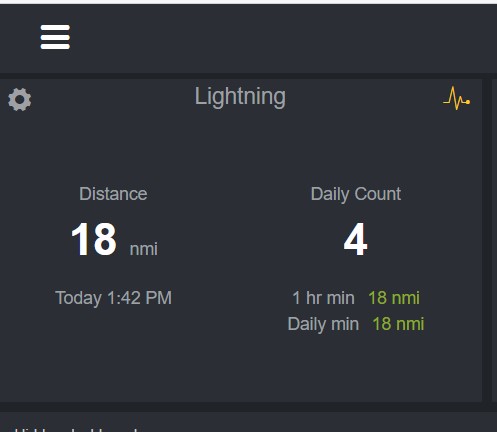

Just a bit more info[attachment=2]

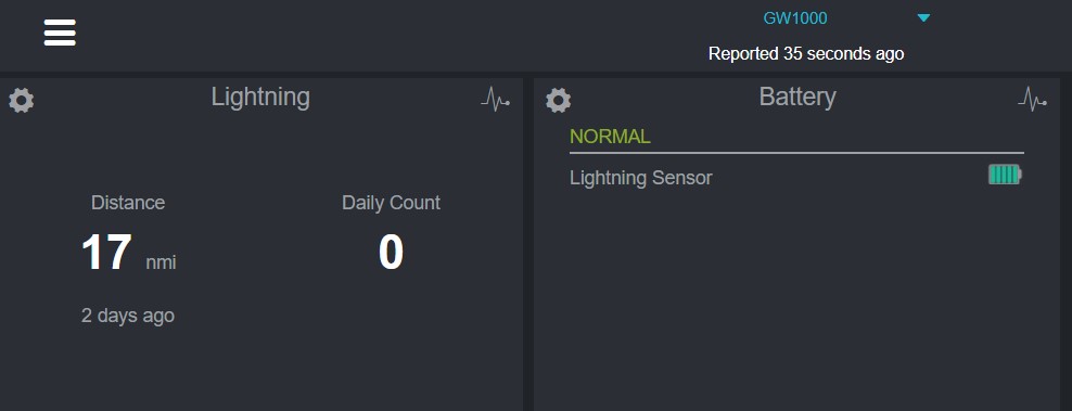

I cant see any lightning sensors showing in the sensor list
My GW1000 and Meteobridge Pro have been updated to the latest versions and rebooted
The lightning sensor is showing in the Ecowitt app
I really dont know what to do next
Graham

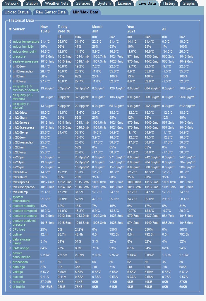

We did have a storm on Monday evening and I recorded multiple strikes which were shown on the Ecowitt Web site
However in my Min/Max data i dont have any lightning sensors showing or any data but I can see data from the temp/pressure sensors in the GW1000
Its station 2 on the attached screenshot
I really dont know where to go next

I have updated to the latest version 1.6.8 - it was updated as soon as it was installed on Monday
Graham

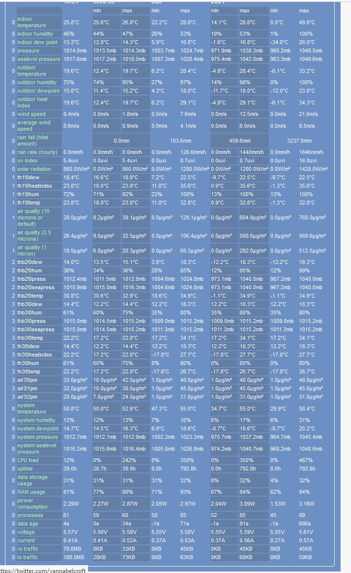

Here is a screenshot of my data from the Ecowitt website
I also have the latest Meteobridge software (28th June)
Graham
Graham

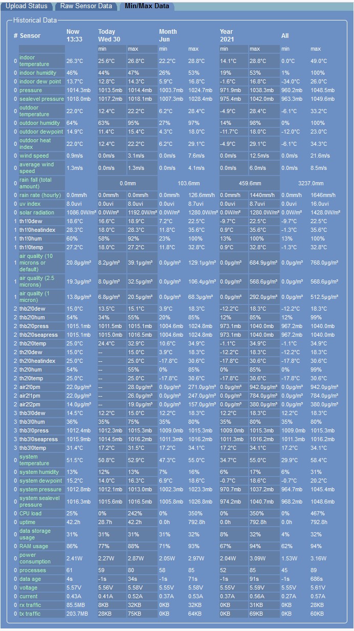

Probably you are the first one with this configuration.
If your GW1000 is close enough to someone else's outdoor unit, you could test if that would help.
The GW1000-API used is very complex and does not use field-names, only relative position in the data stream.
The problem could be in the translation there.

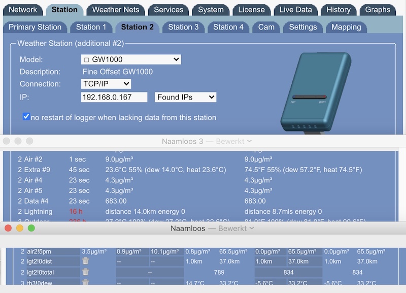

Also, when you restart the GW1000 by removing power or new firmware, the lightning-data is only found by the MB when there is lightning found by the GW1000. So it should be powered on 24/7.
In my test-station the old lightning data is "lost" from the min-max also when restarting the logger.
I attach a screen screenshot from before the logger restart there was 16 hours old lightning.
After restart the lightning data is not in the "Min/Max" tab and not in the "Raw Sensor" tab
They will appear at the first lightning and disappear with a MB-logger restart.

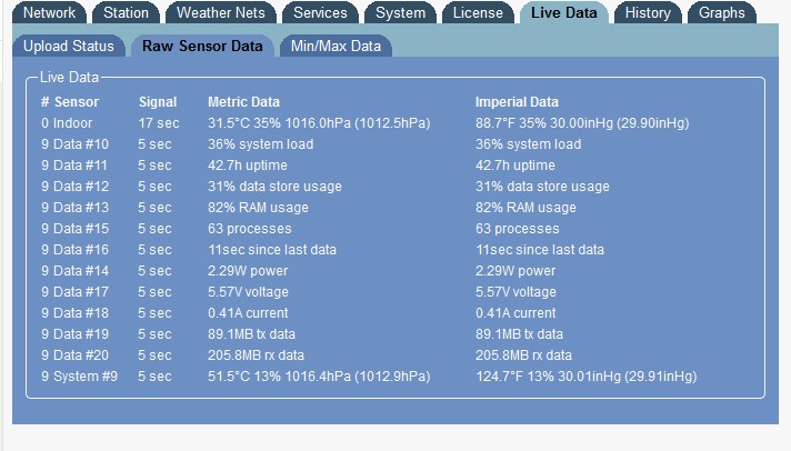

- onlylinghtning.jpeg (144.35 KiB) Viewed 8238 times
Re: GW1000 and WH57 Lightning sensor
** attention: edited in between - may be worth re-reading completely ** 30-Jun-2021 14:37 CEST
a few things:
the GW1000 running without any other basic sensor should show
only Indoor as it did with your first live data posting - where your GW1000 was still station 3.
MB usually picks up the GW1000 properly even when run without an external sensor -
I know of a configuration where it is GW1000 plus two WH41 (PM2.5) sensors and it works fine.
It seems that you have changed the station # meanwhile
And now, after you changed the station # (3 to 2), so you say, the T/H/P data of now station 2 is displayed differently ...
strangely it now shows three different lines, one per sensor, where it should be one line with three sensor data only.
So it cannot be ruled out that the position as a station plays a role (e.g. 1st hardware, then software or whatever)
the way the logger is programmed now.

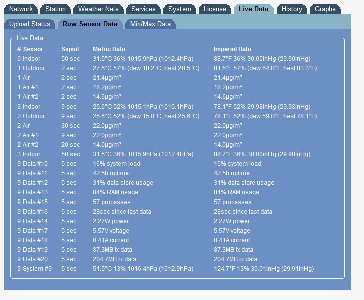

Hi Gyvate

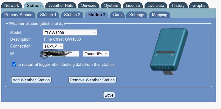

I have done the first test
Station is now configured as Station 3
Primary Station is my Davis Vantage Pro linked to a Weatherlink Live
Station 1 is a Davis Air Quality sensor
Station 2 is a Purple Air Air Quality sensor
Station 3 is the GW1000

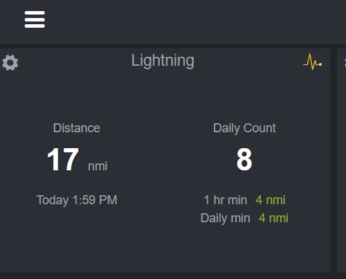

I have attached the Min/Max screen and lightning screen after a simulated strike
Graham I will now do the second test
Great - we need to come back to the original situation where the GW1000 showed only one line (Indoor) - in the Raw Sensor Data view.
A 2nd line "Lightning" is also appreciated
The Raw sensor live data view is also important ! Not only the min/max. The min/max only may be misleading in our situation.

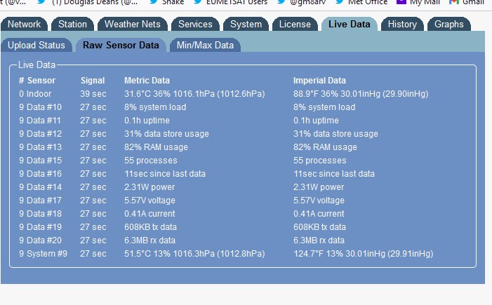

So here is the second test
GW1000 is the Primary sensor
At no stage do I see any lightning sensors in Meteobridge

And here is a test with just the GW1000 as primary station with nothing else configured

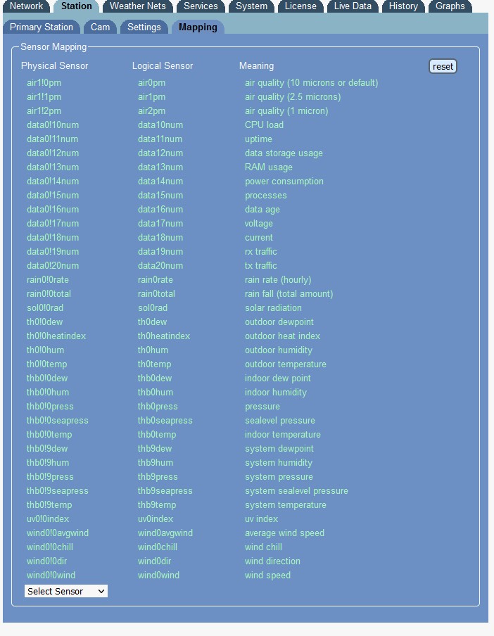

can you check if the lightning sensors are mapped under station/mapping ?
Now that GW1000 is the primary station.
If not, try to map them below (= at the end of the page) at "select sensor"
If we don't get it work now, I can send you a PM with my email

In meanwhile realized that only the Indoor sensors of the primary station are labeled as Indoor in one line.
For station 2, 3, ... they appear as three or more lines.
Strange that it showed in one line on your picture when the GW1000 was station #3 (or log data and raw sensor data are from different situations/configurations).
Hi
I have checked that and I dont see any reference to any lightning sensors
What is strange though is that I only have the GW1000 as a primary station with nothing else configures but I am still seeing air quality sensors even those these arent mapped
Do you want me to leave my meteobridge with just the GW1000 or shall I go back to the original settings as that is the one I would like to work
Graham
Graham
