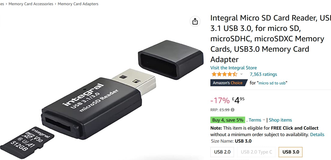

yes - just go to amazon.co.uk and enter "usb micro SD adapter"
you should find something like this:

The microSD card will give you more storage space which you will definitely need after some time with 5 stations and 100 sensors, even if you only have hour-based archiving and not minute-based archiving.
But no increase in processing speed to be expected - and, as Boris mentioned, many side-effect will be possible due to a system overload.
