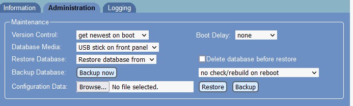

If I select Database Media to be internal USB storage then my Meteobridge Pro Red just stays offline with the errors shown below

I have to select my USB stick on front panel to get it to go back online after a reboot

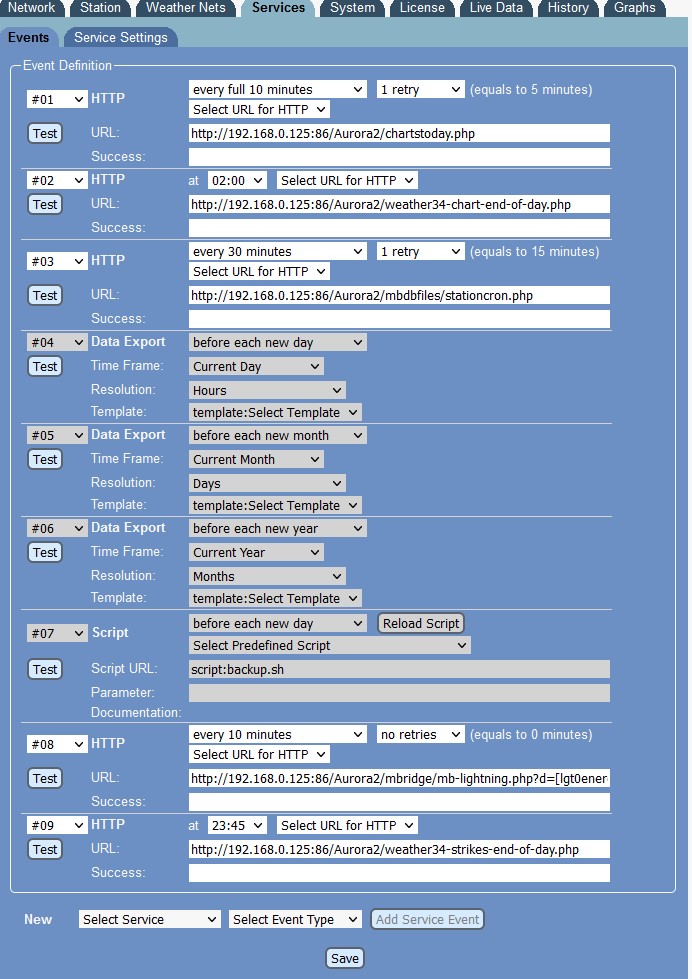

I have attached a screenshot showing my running events
Graham
- events.jpg (179.42 KiB) Viewed 10090 times

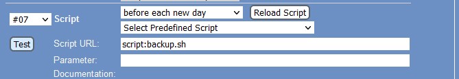

in a MB Pro or MB RPi:
- insert a USB device to the front or back panel (MB Pro) or to a USB port (RPi)
- create an event under services -->events:
- choose a backup interval e.g. every hour, every day (every day is a good choice)
- save
- press test to see if it works
to see the backup you can
a) check the log file (System--> Logging)
b) take off the USB device and connect to a PC
c) mount the USB device (while stick inserted) into the exported file system and look it up with your PC

I have created the event as shown in your screenshot (I had already created an event like that)
When I press Test I get a message to say the event has been triggered manually.

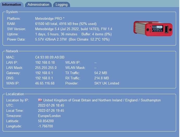

I have a front mounted USB stick
I have attached some screenshots of my system

it looks like your storage is corrupted as it doesn't show on the System --> Information page.
No storage, no file system - nothing to export
under normal circumstances the database files should be under /tmp/mnt
the data subdirectory should be under /tmp/mnt
under /tmp/mnt/data the export, import, scripts, templates directories should appear
however, if the internal USB storage couldn't be mounted, that directory tree doesn't exist.
If you have a properly working internal storage (device), it will be shown on the information page.
But you can check - you'll probably not find the directories
they are rebuilt at each software update - provided the storage is available.
The latter doesn't seem to be the case.

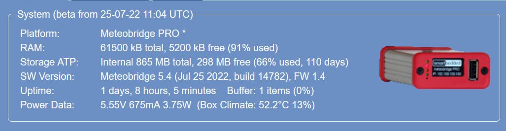

your system-->Information should look like in your picture the storage line is missing
Personal scripts and charts and exports however might be lost.
The default ones will come back once proper storage is there and the application is loaded again from the meteobridge server.
