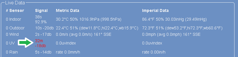

4. Note that in all the above channels the meteobridge receives data from the ISS every 12 to 13 sec!
5. Look at this image again. The meteostick has been trying for 32 minutes to get data from the UV sensor!
I think there is no way the UV sensor is not sending data for 32 minutes!

Not exactly but pretty dam close and close enough based on the specs of the UV and solar sensor. The other thing that has also stood out with this is your signal -db, way over the top?

Referring to the Live data Signal being in the sub -20db, such as UV signal of -14db and -18db? Have a couple of systems that literally sit on top of each other in repeater and non repeater configs and see around -40db signal strength so looking at what might appear odd or abnormal in your config.
The problem is when trying to diagnose something like this one only get to see what limited output is provided.
