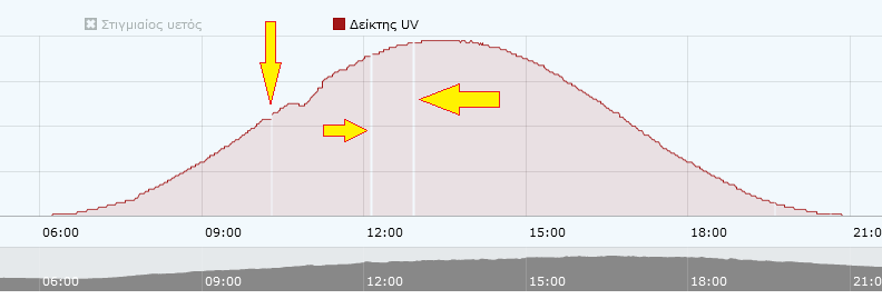

A month ago I added a UV sensor to my Davis Pro2 transmitter(ISS).

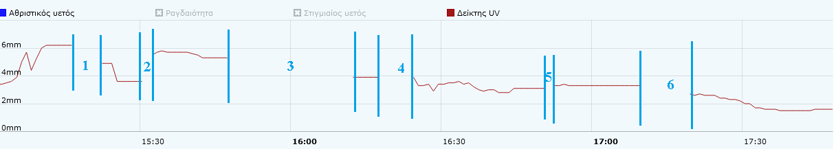

I noticed that in the UV diagram there are periods of time from 3 to 20 minutes sometimes, in which the communication between the meteostick and the UV sensor has been interrupted!

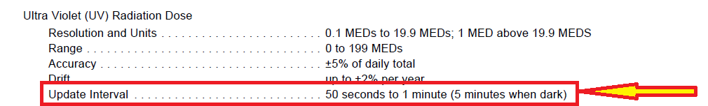

The meteostick receives data from the UV sensor every 12-13sec. This update time is not suitable to receive data from UV sensor, because UV sends data every 50sec to 1min!
In the attempt to communicate with the UV (every 12-13sec) 20 minutes can pass without success, with the result that sometimes small and sometimes larger gaps are created in the UV diagram.
If the communication time changes from 12sec to 6sec, I think the problem will be solved, if I'm not mistaken.

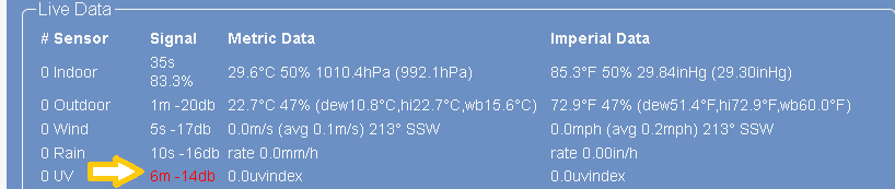

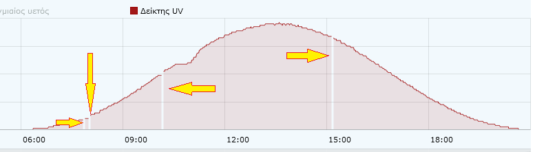

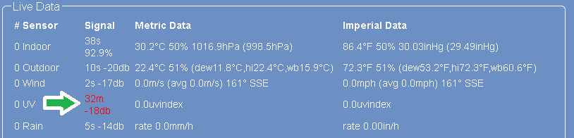

The meteostick tries for 32 minutes to receive data from the UV sensor!
I think that it is not possible for the UV sensor not to send data for 32 minutes!

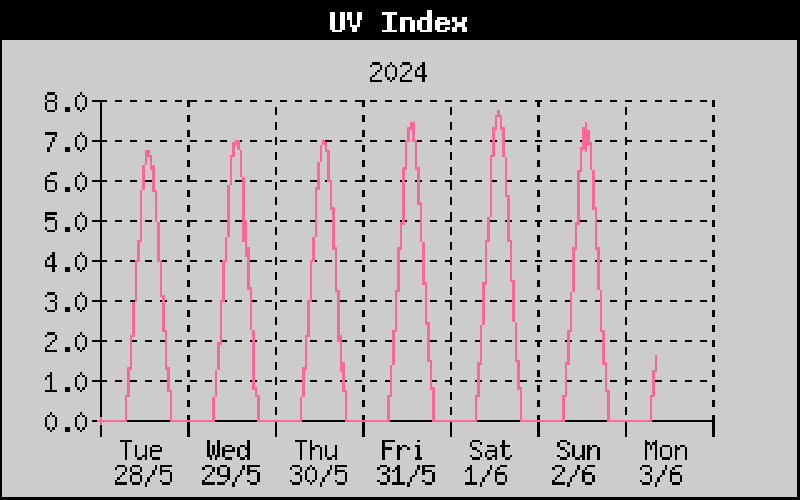

weatherlink UV MAX1.png (7.92 KiB) Viewed 3696 times
weatherlink UV MAX2.png (41.95 KiB) Viewed 3696 times

What is the actual configuration of the ISS sensors and relationship (distance etc) to the MB? Where you mention using a relay (-14db), a relay from where and how exactly?
Those signal strengths of sub -20db are really weird? How are these figures achieved?
The meteostick is 20cm away from the VUE console, that's why these numbers are achieved (-20db)!

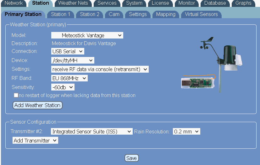

And Mb>Station>Weather Station (primary) Settings: receiver RF data via console (retransmit)
See the image above “weatherlink UV MAX2.png”

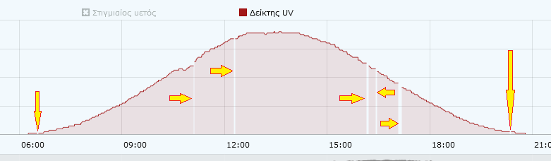

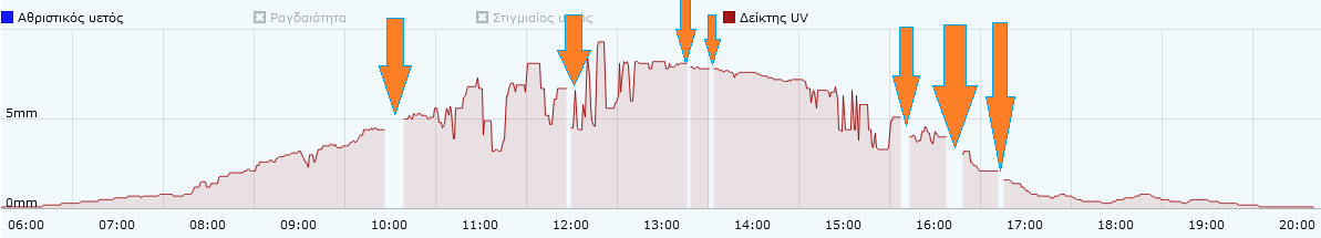

From 3/6/2024 to today (14/6/24) the UV charts show a lot of gaps like today. (note that the UV charts from weatherlink do not show gaps!)
