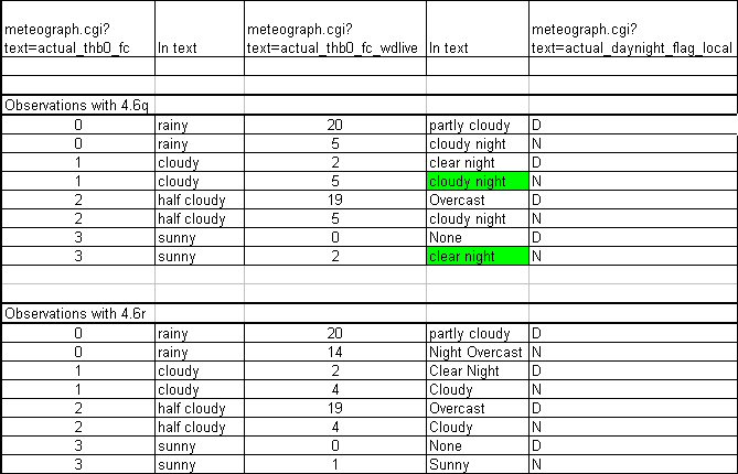

YJB
Posts: 387
Re: Request to reflect day / nighttime in clientraw icons (1
Post by YJB »
I'm still not too sure about the text values.
I've gathered all the possible options on my RFXCOM/WMR968 sensors and this is what I see
As one can see quite a bit of differences between 4.6q and 4.6r, but I don't think that the fc as being read from the sensors is translated properly into the wdlive text counterpart.
But then... I might be wrong....
