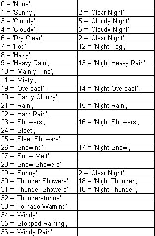

In short - client raw field 15 doesn't reflect daytime nighttime icons. All icons are daytime based. This issue surfaced after Boris implemented the "Day Night Flag (field 610 in clientrawextra.
If tried to compile a table to reflect the various icon numbers in day/nighttime. It seems that this is not a one by one translation, so you will see some gaps. Also, feel free to comment if you don't agree with the substitution of a particular field:
Icon Values.jpg (60.33 KiB) Viewed 11425 times
Boris, are you able to squeeze this sometime in an update? We are basically just looking for a code change that "translates" daytime icon value to nighttime value when the 'Day Night Flag' is "N" for those stations that do not generate all 34 different conditions. (actually, I don't know if there are stations that do generate all these values)

Yes. This would be a great addition to the Meteohub. That matrix looks good to me.
Boris has already implemented daytime icon translations for the VP2 (Thanks, Boris!). Hopefully a similar addition for the other stations and an extension of the existing translation for the VP2 stations would be all it takes.
