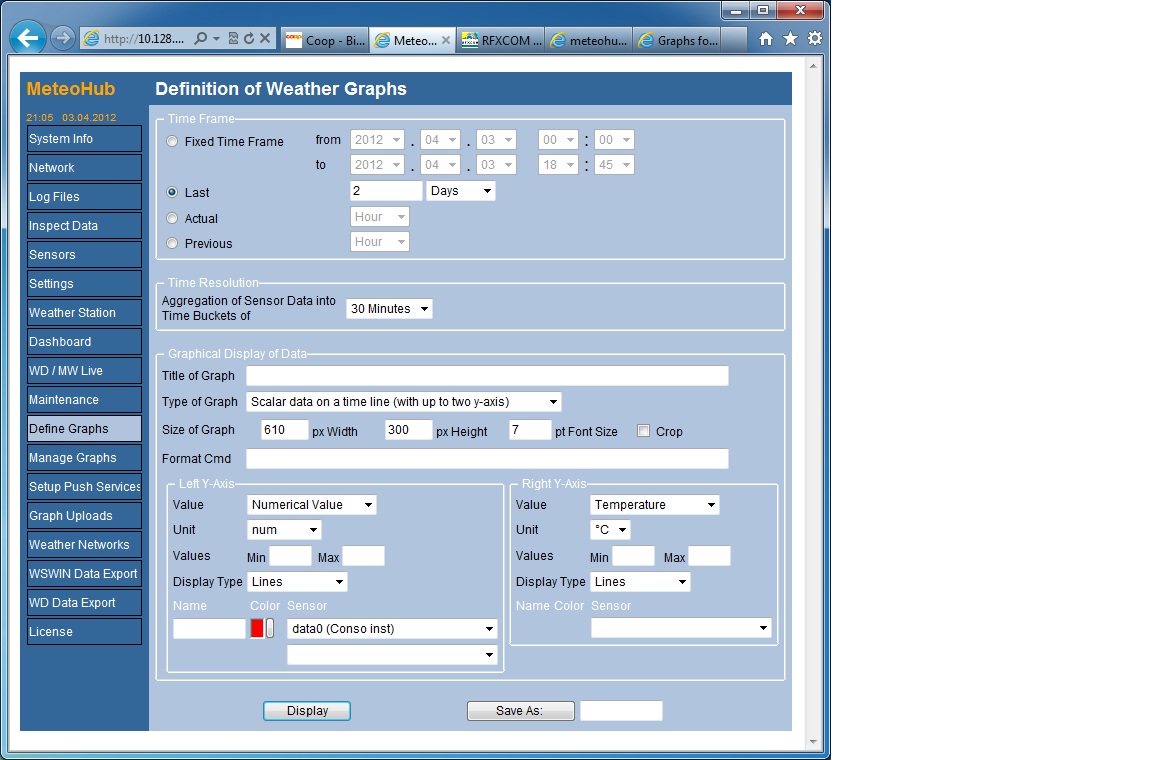

I try to do a graph with my power comsumption but I receive a message asking me "No Data gnuplot execution failed" :?
I try different type of data but I receive ever the same message.
Posts: 8033
Re: OWL CM119 and rfxsensor not show in meteohub
without seeing your definition on sensors page and without seeing your graph definition no one will be able to help you fixing your setup bug.

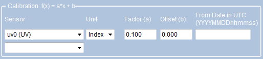

Point 1 : No data displayed on meteohub. I can receive data on my pc with the rfxtrx
The attachment Capture.PNG is no longer available
Ponit 2 : uvi goes normal ( like the wmr200 ) to 3 and upper 3 meteohub display nothing, On my WMR200 I can see uv upper 3 uvi.
For your information I had to multiply by 10 the uvi info into meteohub to have the good uvi, like this
The attachment Capture2.PNG is no longer available
PS : Sorry for my english :(
