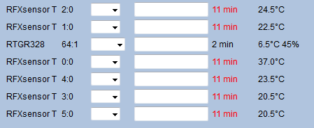

Re: OWL CM119 and rfxsensor not show in meteohub
Looks like Meteohub had finally picked up some RFXsensors. But just Temperature sensors, is that correct?
jperillo
Posts: 16
Joined: Tue Feb 28, 2012 9:11 am
Location: Mont sur Rolle (CH)
Post by jperillo »
Yes is that correct ! Wonderfull ! Can meteohub see my power consumption via the cm119 ?
Did you enable only oregon and x10 ?
