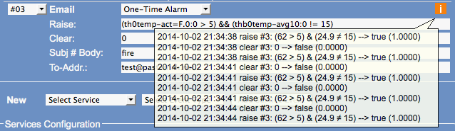

Please give just released update a try, that should hopefully solve all the issues with expression evaluation. New features are:
  • Variables can be used with or without enclosing square brackets. If used without, please make sure there is a blank before and after the variable. Apart from this, there is no need for separating operators etc by blanks.
  • Variables can use all defined qualifiers, like "th0temp-act=F.0:0".
  • There is no longer a distinction between simple and complex conditions.
  • Logical operators in expressions for "and" are "&" or "&&", both have the same meaning, some with "or" which can be "||" or "|".
  • The "i" icon shows history of latest evaluation of raise and clear conditions. To get more recent history reload "Push Services" tab by clicking onto the tab and then going back to the "i" icon.
  • The "i" icon also lists errors that have occured during condition evaluation.

Can you please post the "i" icon help text showing the evaluation of your formular?

I know it's not fired because I have another alarm configured to raise when the clear condition is true, and that alarm is never raised. It's difficult to catch the "i" icon in time because I'm not usually sitting next to my PC to capture it when this situation occurs. By the time I get to the PC, turn it on, and log in to Meteobridge, the condition is gone from the "i" icon. A log would help a lot.
