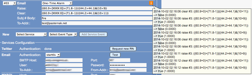

I found a bug in evaluating logical operators "&&" and "||". The just released new version does fix this, and adds an "i" icon to be clicked for checking last evaluations of alarm conditions. This should help understanding what happens. Spaces are no longer needed.
Please be aware that square brackets (indicating use of variables) must be in the condition in order to have the complex themes evaluated. If you want to test with bare numbers please add something like "+ [XYZ:0]" to one of the numbers, as this adds zero but provides the square brackets.

Thank you for investigating. The hard-coded test case was only for debugging a condition constructed of variables. The tooltips are helpful, but in Firefox it doesn't display the comparison operators correctly and the "&&" and "||" are displayed as single characters. I suspect they're not HTML encoded (e.g., <, >, etc)?
