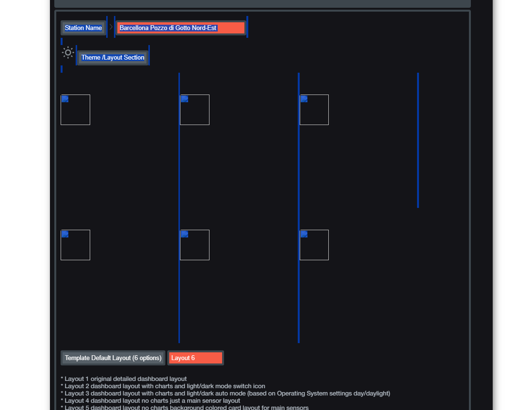

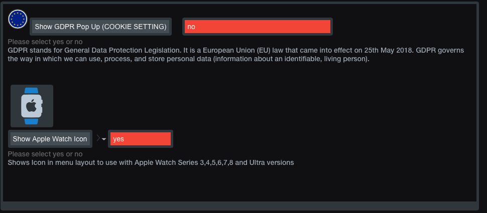

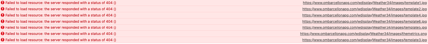

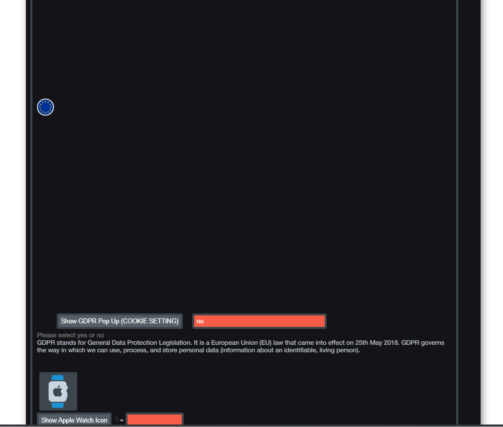

Hi guys,
I have some problems with the Weather34 admin panel, I updated to the latest version available and I have Php 8.2.8, practically you can't see the images of the layouts, and you can't see the part where the GDPR is, I've also attached pictures.
What could it be due to?
For the rest the dashboard seems to work ok.
https://www.ombarcellonapg.com/wdisplay ... layout.php
- layout.png (48.55 KiB) Viewed 55583 times
- gprd.png (37.28 KiB) Viewed 55583 times

good afternoon

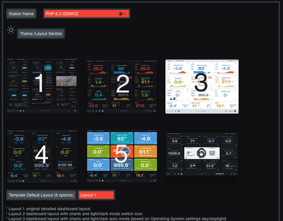

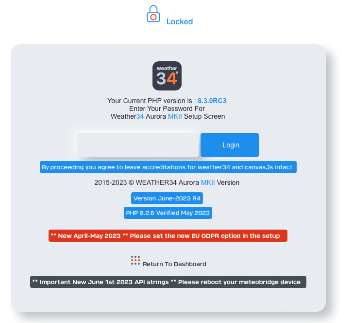

i cant be of much help but I am using 8.3rc which is a later revision than your using https://www.php.net/archive/2023.php#2023-09-28-2
!!! provided some screenshots below .
is there some cache be it browser , server . ?
are there any PHP modules not set ? (often can happen by default on new PHP installs/upgrades)

I'm checking on the server side if there is cache, while on the browser side any use gives me the same bug.
How do I understand if there are any php modules not set?
A thousand thanks
A thousand thanks

looking closer at your screenshots it just looks a case of missing images .. best thing send me your password to the setup screen i i can see what the error is being logged through the source in the browser ..you can change password at any time ... brian34design "at" icloud.com
Ok thank you!weatherist34 wrote: Tue Oct 03, 2023 2:38 pm hi

as I thought it is just missing images i will try and send them along wednesday via email ..brian
