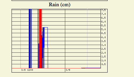

I think there is a problem somewhere in terms of rain yesterday switched to RPI2 with Meteohub and gave AWEKAS and reporting and other weather networks that there is a very large rain measurement.
Nothing has changed in the config exactly the same as the Awekasbox, do not know what this could be and all weather networks received this data, I am ashamed a little hahaha.
Now back at Awekasbox.
Schermafdruk 2015-03-09 09.33.55.png (14.13 KiB) Viewed 3993 times
Re: Raspberry pi B+ 2
You should mark the record that has the jump in the rain counter value as deleted on "inspect data" page.
