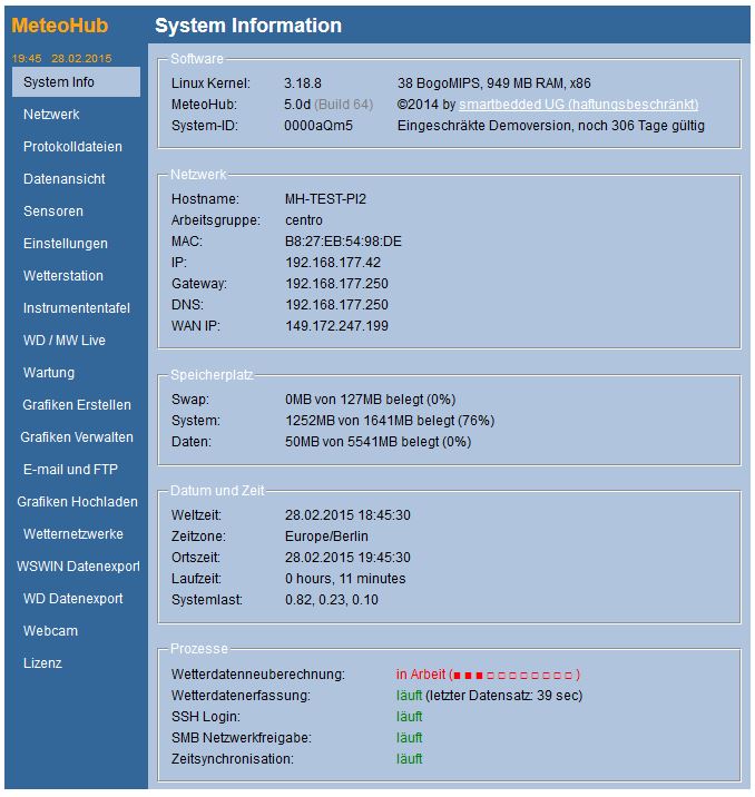

MH main page shows 38 BogoMIPS, 949 MB RAM with Linux Kernel 3.18.7, Meteohub Version 5.0d Build 64, eingeschränkte Demoversion.

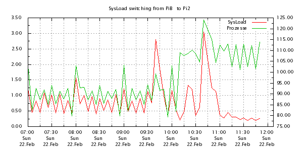

Sysload is about 0.43, 0.29, 0.29, after recalculation (starts from 11:00 in the following diagram)

After starting a recalculation of 2 months data the list of processes (TOP, command "1") shows this:
at least there is some life in all 4 cores - and the Pi2 is feeling much quicker in its reaction in a linux terminal and in MH.

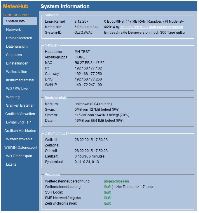

Here in short my steps (did it testwise half an hour ago again):
- transfer mhrpi5.0.img to 8Gb micro sd card
- test: does not boot on pi2 (because of old linux kernel 3.12.26)
- start on b+ is OK
- on MH main page: Demo timed out - -> update to 5.0d -> install 5.0d -> automatic reboot -> reload conf -> runs OK
conf-reloaded-and-running-on bplus.JPG (87.56 KiB) Viewed 13827 times

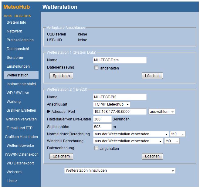

- after some re-configuration (showing some errors) this is the result:
- data comes from my "production" system via TCP/IP:
Some problems I noticed until now:
on SSH:
- wear storage shows problems
- smb.conf.bak has "disable poolss" instead "spoolss" - spelling error, gives sometimes the result of exim4 logs filling the disk
- Netzwerk: Huawei GSM USB shows up
- CPU-temp does not show
- some error messages on SSH and in changing some points in MH main page
- processor type is shown as x86 instead of Pi2
