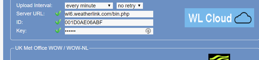

Yes, green marks
Gert
2019-10-25 (3).png (29.19 KiB) Viewed 6868 times

Boris, superduty is have a similar issue as gand except his isn't showing the green check on the live data page. Settings all look okay to me.
