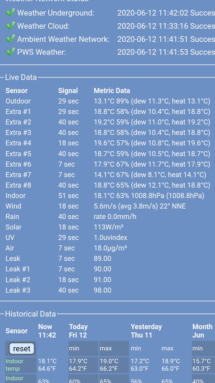

Running the new Meteobridge update.
Meteobridge 4.3 (Jun 12 2020, build 3113), FW 1.3
All my sensors are enabled in the GW1000 and there is no issue with missing rain data anymore. All my 4 water leak sensors are enabled and I have rain data working :D
Meteobridge is reading the leak sensor data.
CH1 = Leak 89.00 Normal / 345.00 Leak
CH2 = Leak #1 90.00 Normal / 346.00 Leak
CH3 = Leak #2 91.00 Normal / 347.00 Leak
CH4 = Leak #3 98.00 Normal / 354.00 Leak
But I cannot see any leak sensor uploaded to Ambient.
A lot of progress made today with Meteobridge/GW1000 issues :D :D
Thank you to all involved.
