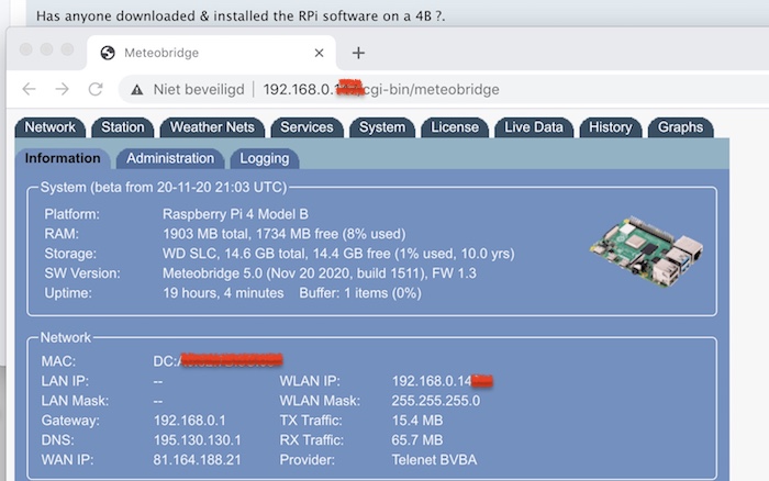

Has anyone downloaded & installed the RPi software on a 4B ?.
I successfully downloaded and installed it on a 3B+ but I’ve downloaded the 4B version numerous times on three different computers and flashed it to several different SLC micro SD cards and cannot get it to load and run on my 4B except once and when it did load and run on the Ethernet connection it didn’t successfully reboot after changing it to my WLAN,
Re: Meteobridge supports Raspberry Pi 3B, 3B+, 4B
Yes, no problems.
Do you use a supported SLC card for storage?

I’ve tried both the ADP 2GB SLC card and the Western Digital / San Disk 8GB SLC card recently added to the supported cards list. Neither will boot. I’ve downloaded and flashed both cards on both a Windows Computer using etcher and on a Mac using both etcher and Raspberry imager. I get the same result. The Act led flashes a few times, the red led goes on and then goes off. No led activity after that. The RPi boots fine with a Buster microSD card.

The only thing left to try is another power supply. The specifications for the 4B say to use a 3 Amp supply. I’m using a 1 amp supply now but have the correct supply arriving tomorrow. Hopefully that will solve the issue but I don’t know as the Raspberry Pi OS Buster which I’ve installed on a microSD card boots fine though it won’t access Wi-Fi which may be caused by the low power supply. Have to wait and see.

During development I flashed many microSD cards with a lot of test images. I did with "dd" from Mac OS command line (unmount sd card first, copy image via "dd", unmount sd card again, pull out sd card). It worked fine with every image a created and also with all cards.
RPI 4B is know to have problems with some 100 Mbit switches, but this would at least let it boot, but then stuck in fast flashing LED mode. Your issue seems to be before that. A too weak power supply might be a good explanation. I know from development of the NANO that switching on the Wifi is a power sipping event. I had to use large capacitors to help the weak Davis console power supply to survive.
