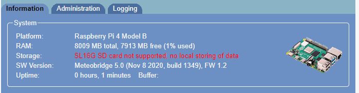

today I suddenly see something strange.
The system ran so far without this message.

- rpi.jpg (21.36 KiB) Viewed 101469 times

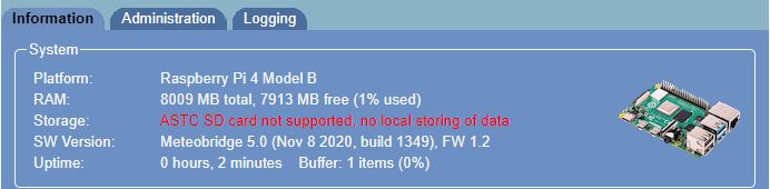

This message also comes up with the original RPI card.
- rpi.jpg (21.1 KiB) Viewed 101466 times

Meteobridge software enforces use of industrial SLC micro SD cards. Says so right there in the original post on this thread in the second paragraph.

Which card would you recommend?
Re: Meteobridge supports Raspberry Pi 3B, 3B+, 4B
From the Wiki:
swissbit SFSD1024N1BM1TO-I-DF-2A1-STD (microSD Card, 1 GB, SLC Flash, -40°C - 85°C)
swissbit SFSD2048N1BM1TO-I-DF-2A1-STD (microSD Card, 2 GB, SLC Flash, -40°C - 85°C)
swissbit SFSD1024N1BM1TO-I-DF-221-STD (microSD Card, 1 GB, SLC Flash, -40°C - 85°C)
swissbit SFSD2048N1BM1MT-I-ME-221-STD (microSD Card, 2 GB, SLC Flash, -40°C - 85°C)
swissbit SFSD2048N1BM1MT-E-ME-221-STD (microSD Card, 2 GB, SLC Flash, -25°C - 85°C)
ATP AF2GUDI (microSD Card, 2 GB, SLC Flash, -40°C – 80°C)
Cactus KS2GRIT-803M (microSD Card, 2 GB, SLC Flash, -45°C – 90°C)
Panasonic SMSC02DA1 (microSD Card, 2 GB, SLC Flash, -40°C - 85°C)
Apacer MSD02GIDI-T (microSD Card, 2 GB, SLC Flash)
Only these listed microSD cards are recognized by the Meteobridge Software as supported microSD cards !!. Any other microSD cards Will Not be recognized by the software as supported even if labeled as Industrial ( which does not necessarily mean it has SLC memory ).
The ATP AF2GUDI is available on eBay for about $20 with shipping ( item # 193697994136 ),
or an even better deal. Five ( 5 ) ATP AF2GUDI microSD cards for $25 including shipping on eBay ( item # 184512207900 ).
