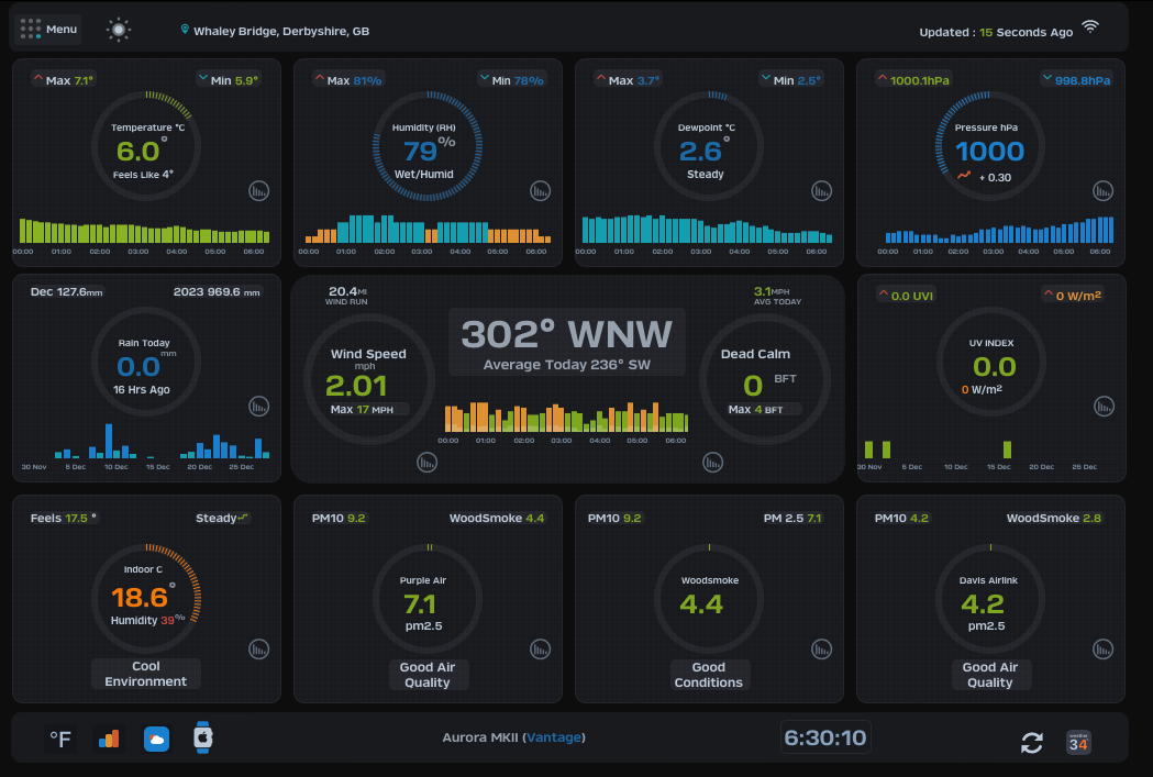

I have a working demo of new layout Theme 8 at https://whaleybridge-weather.com/weathe ... yout-2.php
if you would like test this and provide some constructive feedback please get in touch . its not ready 100% more likely mid January.
@alex yes supports mmHg
screenshots
Screenshot at Dec 28 16-43-59.png (206.03 KiB) Viewed 365449 times

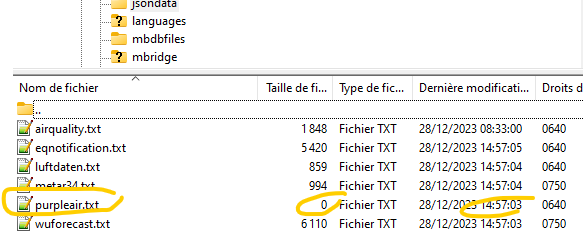

weatherist34 wrote: Thu Dec 28, 2023 3:53 pm hello
try deleting the file purpleair.txt in the jsondata folder and run it manually again
:oops: systematically it recharges but empty
Capture d'écran 2023-12-28 145735.png (24.31 KiB) Viewed 365448 times

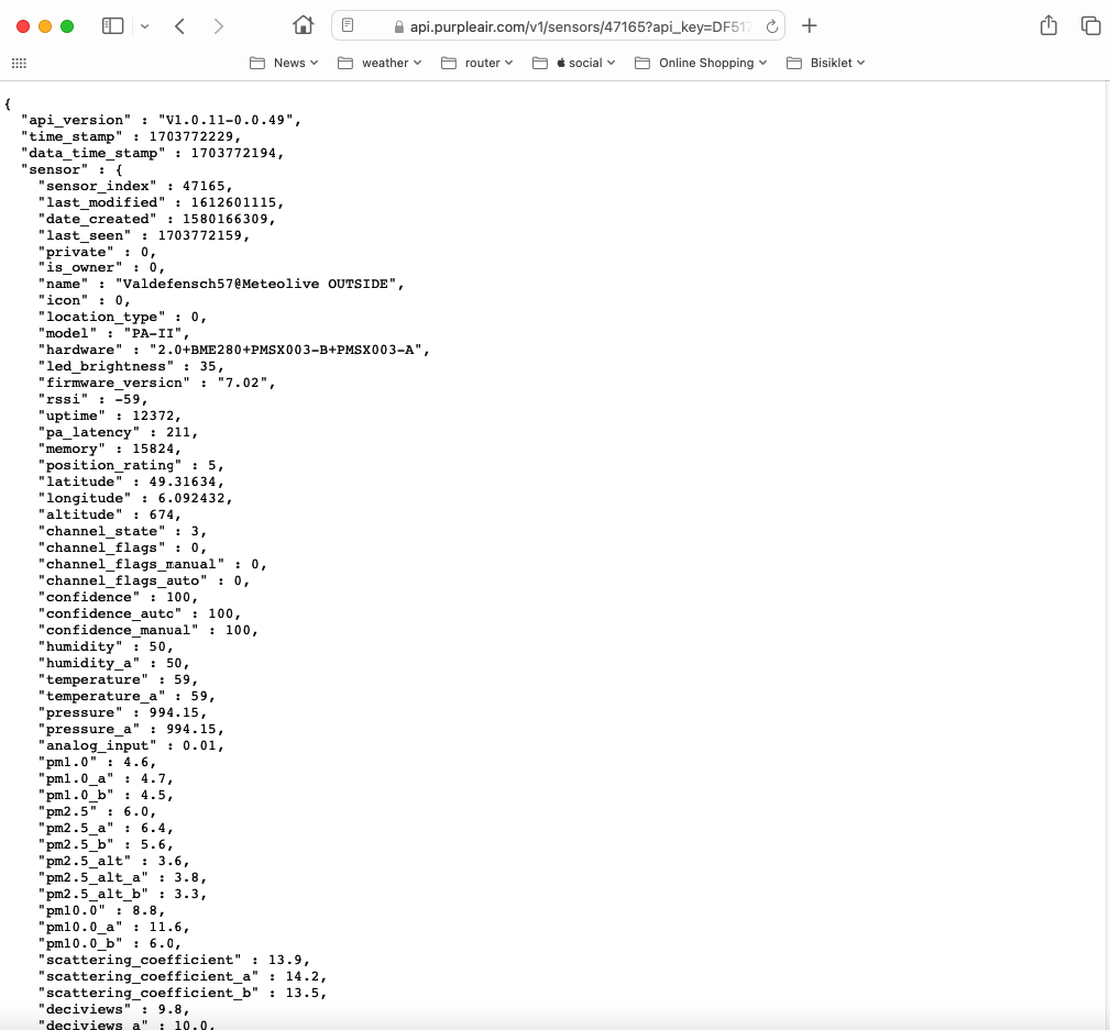

in your browser test this for api return
https://api.purpleair.com/v1/sensors/47165?api_key=put your API key here
this works me see below

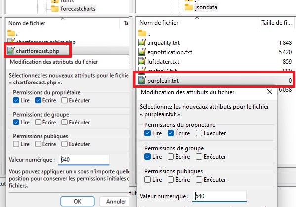

meteolive57290 wrote: Thu Dec 28, 2023 4:18 pm :wink: i didn't doubt it for me too, it works except for the template block :?
file permissions ! if there no data in the file no data gets displayed .. if you complicated server setup or structure then could give you problems
http://valdefench57sgz.franceserv.com/p ... recast.php is also using stationcron.php so if the file was the issue you wouldnt see forecast data . im betting on file permission ! because its blank ..brian

:oops: usually I use Filezilla for ftp access
screen if I check the authorization compared with pws/forecastcharts/chartforecast.php
where once again sorry if I'm going the wrong way :(-
Capture d'écran 2023-12-28 153554-horz.jpg (92.3 KiB) Viewed 365429 times

ok i saw it in the email, i placed my PA api key and again nothing so definitely server related to that file , as a test set all permissions on that purpleair.txt file 777 just as a test
then run yourdomain/pws/mbdbfiles/stationcron.php
