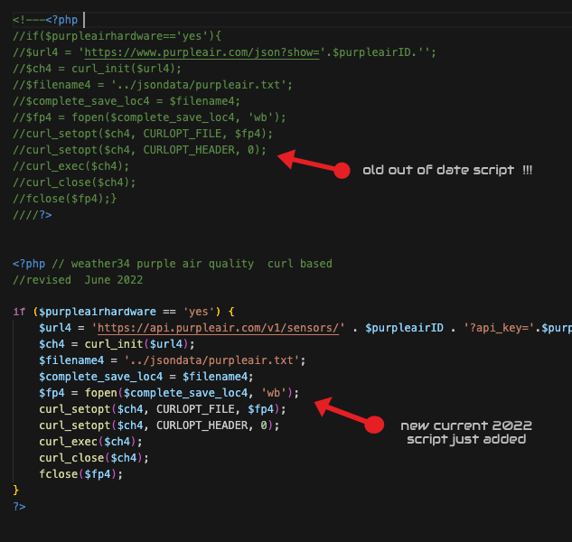

weatherist34 wrote: Thu Dec 28, 2023 5:38 pm ok i saw it in the email, i placed my PA api key and again nothing so definitely server related to that file , as a test set all permissions on that purpleair.txt file 777 just as a test
then run yourdomain/pws/mbdbfiles/stationcron.php
hello obviously it continues not to work even with your instructions systematically I have an empty .txt file and no data recovery in the block_template :?: :?: Regards
good morning
you have a localised issue what it is I dont know and not possible for me to diagnose unless you want to provide FTP access thats all I can offer, all sites using purple air use the exact same script and nothing has changed in how purple air modules collects the data via the API since introduction of CO2(VOC) which at a guess was 2020-21 so same script still in use. some examples below..brian
https://singaporeweather.info/weather34-full-layout.php
https://woolfg.hyperphp.com/Ringwood/we ... layout.php
https://whaleybridge-weather.com/weathe ... yout-2.php
ps was you the same guy/user from weather display many years ago(year 2016 at a guess) if so I seem to remember there were some specific issues related to your sites forgive me if Im wrong ..

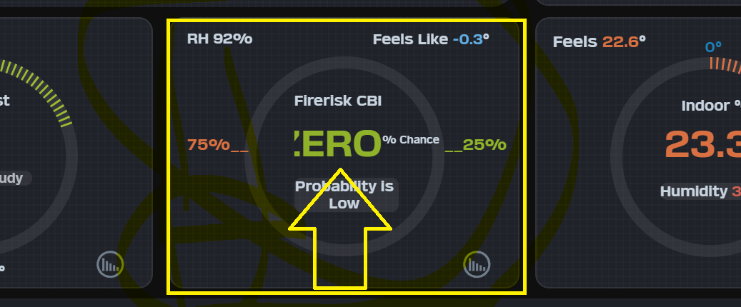

Small problem on both Chrome and iOS.
Immagine 2023-12-29 110753.png (102 KiB) Viewed 581536 times
:| I found in my archives a backup from January 2022 where the PurpleAir script was functional for me for the same sensor
without referring to the new API and mentioning that I have not modified in my hosting setup??
an inspection I think will not give much!! what continues to concern me is that each time the "stationcron" is launched manually
I systematically have a null .txt file AND ONLY for this script?? and this exclusively after updating the template (after prolonged inactivity on my part)

@meteolivexxxxx provide FTP access via mail i will look closer but I can assure you nothing changed in respect to purple air otherwise multiple users would be highlighting same issue your seeing.

lorenz1982 wrote: Fri Dec 29, 2023 12:15 pm Small problem on both Chrome and iOS.
Lorenzo next update

weatherist34 wrote: Fri Dec 29, 2023 12:26 pm @meteolivexxxxx provide FTP access via mail i will look closer but I can assure you nothing changed in respect to purple air otherwise multiple users would be highlighting same issue your seeing.
:wink: thnx okay Brian i just @ you right away :arrow: Regards
thanks got the ftp and now ok its working now you had a very old stationcron file see below ,ive added the most recent script your existing script was either modified or just way old method.dont know but sometimes i need closer access to diagnose , it was to easy to spot ..have a good day..brian
https://valdefench57sgz.franceserv.com/ ... pleair.txt timestamp below Friday, 29 December 2023 11:31:19

weatherist34 wrote: Fri Dec 29, 2023 12:58 pm
Lorenzo next update
Thanks for everything you do.

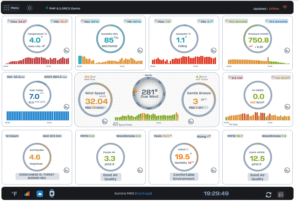

Torsten
taken the compass layout from the airport popup ..is this something better than text ???
i dont have the enthusiasm to compile brand new stuff when there a few alternatives in the various layouts ..brian
Posts: 259
I like it, thank you. :)
ToTo wrote: Fri Dec 29, 2023 5:07 pm I like it, thank you. :)
ok cool that was relatively easy .. any other ideas ? a bit of time on my hands at the moment wife has "MAN FLU" so some isolation all over again :( ...
ended up like this which is very easy to maintain ..
