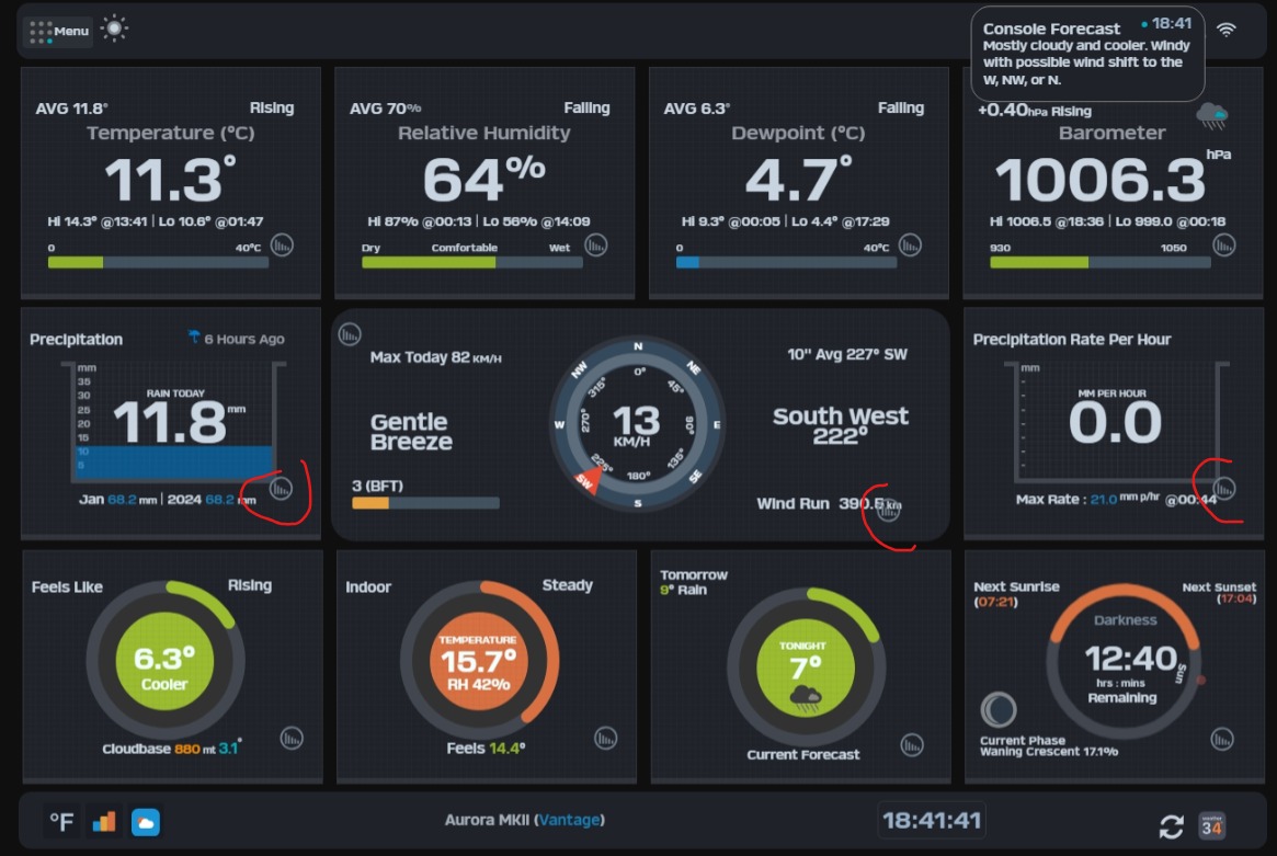

HI Brian,I noticed that there is this alignment problem on theme 6
- Acquisisci schermata Web_7-1-2024_184152_meteoroccamezzomonreale.altervista.org.jpeg (170.09 KiB) Viewed 454442 times

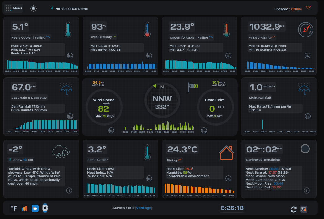

good morning xxvincxxvincixx wrote: Sun Jan 07, 2024 7:47 pm HI Brian,I noticed that there is this alignment problem on theme 6![]()

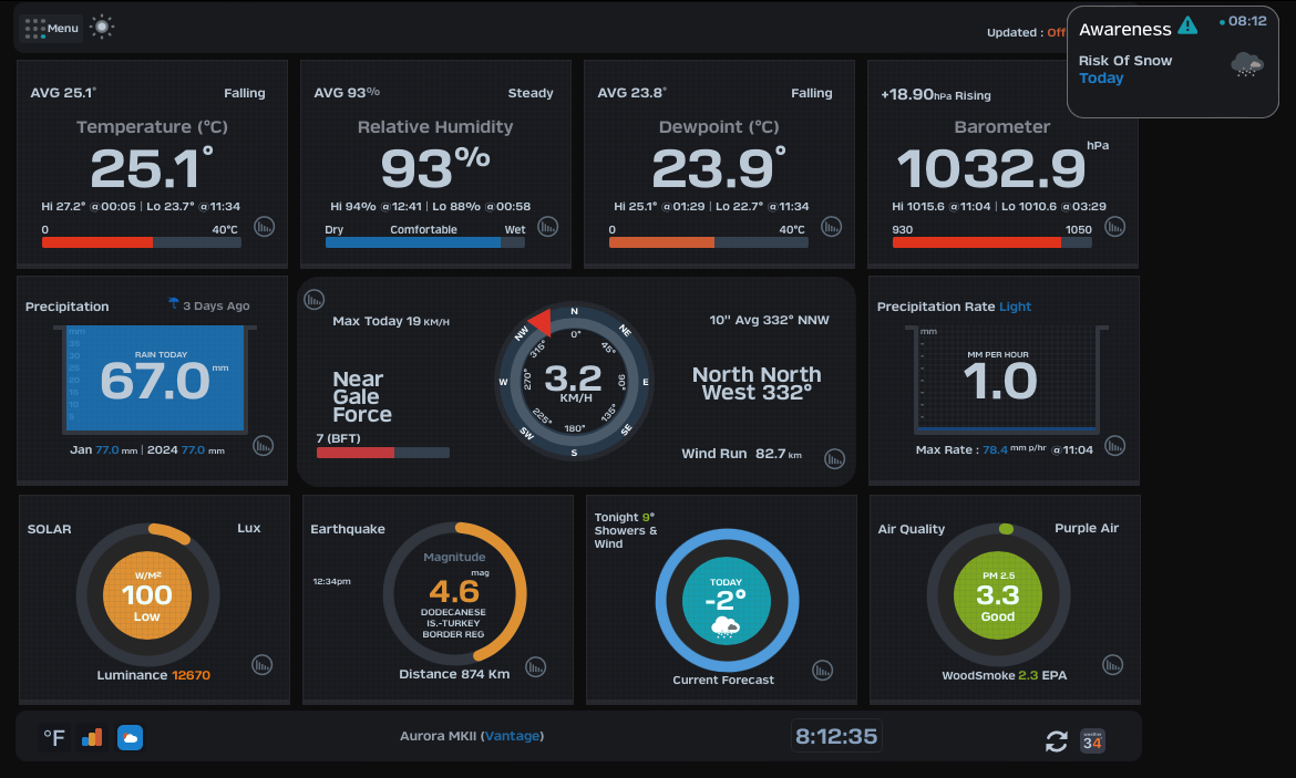

thank you all fixed , will release update later in the week(thurs/fri) back wednesday but late..
also new theme 9 as requested hope its of use its very balanced
https://www.paulwilman.com/pw/weather34 ... yout-3.php
your fix below screenshot and theme 9..brian
Thanks Brian for the fix,I'm waiting for new theme. Is very beautifulweatherist34 wrote: Mon Jan 08, 2024 7:25 amgood morning xxvincxxvincixx wrote: Sun Jan 07, 2024 7:47 pm HI Brian,I noticed that there is this alignment problem on theme 6![]()
also new theme 9 as requested hope its of use its very balancedlive demo at

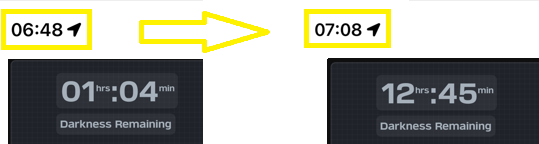

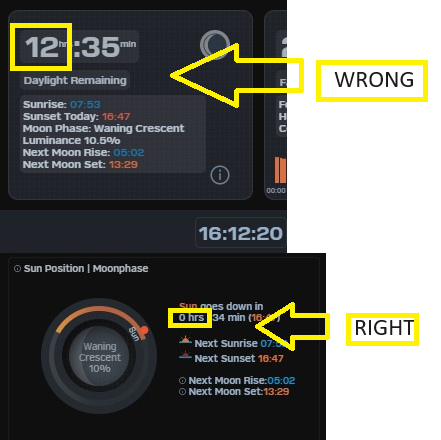

Hi Brian.
"Daylight remaining" error on the theme 7 and 8.
- Senza titolo.png (127.12 KiB) Viewed 452966 times

Lorenzo ive looked at the script which is basically identical to original sun modules etc apart from the css , i made one minor change but I think its related to sun elevation position as the darkness phrase kicks in when sun below horizon or below zero degrees elevation.
anyway its something that needs specific monitoring at the point of transition from daylight to dark but im never around at computer at that specific time.
Simple update January 10th 2024
https://www.mediafire.com/file/nmhuuotc ... h.zip/file
Master https://www.mediafire.com/file/4t58g74x ... 4.zip/file
Adds theme 9 layout less emphasis on circles
see screenshot below or demo at https://whaleybridge-weather.com/weathe ... yout-3.php
contains other fixes mentioned in this thread last few days .
.brian

The error occurs both at sunrise and at sunset, only when it should be 0 hours.
It appears 12 instead of 0.
Sorry for my english, see image.
- Senza titolo.png (19.27 KiB) Viewed 435798 times

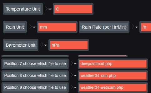

http://valdefench57sgz.franceserv.com/p ... hboard.php

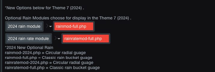

hello despite the configurations saved in my admin dashboard for location n.8
i cannot correctly display the chosen block (rain_php)
on the following layouts and for the "barometer" block
despite the chosen value (=hPa) all display the variable (=mnHg) while the charts are correct for the unit
here is it by default ...
Thnx and have a good day
- Capture d'écran 2024-01-10 093244-vert.jpg (76.24 KiB) Viewed 434453 times
- Posts: 1824

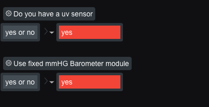

you had set to rainmod-2024 /rainratemod-2024.phpmeteolive57290 wrote: Wed Jan 10, 2024 11:11 am http://valdefench57sgz.franceserv.com/p ... hboard.php
i cannot correctly display the chosen block (rain_php)![]()
despite the chosen value (=hPa) all display the variable (=mnHg) while the charts are correct for the unit![]()
rain/rate theme 7 only choose rainmod/rainratemod-full.php ..ive logged in and changed it to full ..
you had use mmhg set to yes , ive logged in and changed it to no ..
..brian...ps please use https://
