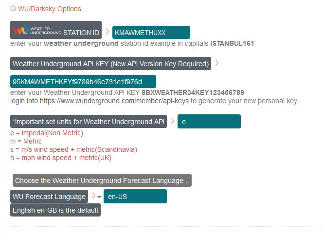

There is a section in the main template setup page for the WU API key. You need to obtain the key from the WU site. See the section screen shot below.
..Ron
..Ron

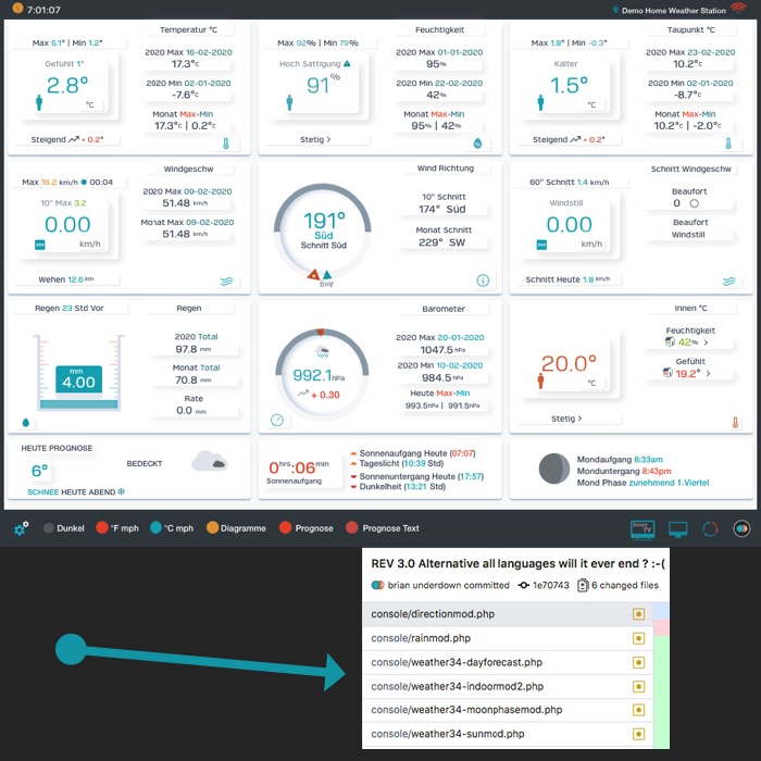

good morning sorry for delay in responding very little time to focus on these until this morning.
alexeysailman added mmHG option module in setup screen to use a file called barometer mod-mmHG.php
..todo add same mmHG formula to charts for pressure.
toto..adjusted refresh module rates might solve what your seeing not able to replicate locally . file console/updater2.php
Ed_Heaton . thank you for bringing this up your doing nothing wrong I hadn't realized I had a backlog of files not pushed to the GITHUB repo via the APP
I use so this morning I have updated many files to the standalone console version there were 24 files awaiting
. took me a while to realize has I couldn't fathom out why the forecast would not display.
please update * note these files are for the console standalone version that supports NANOSD/Pro/TP Link(types)
all language files in the languages folder
console-setup.php (this adds the options for wu api key your not seeing + purple air ID + mmHg option)
stationcron.php which resides in the folder mbdbfiles folder (this is critical for forecast display)

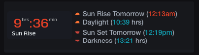

On a side note the "sunrise and sunset" times are in 24 hour format and I don't know why... I did change the format in the setup to 12 hr... Certainly not a deal breaker
Any thoughts?
Any thoughts?
- Posts: 1824
ok no worries thats a pretty easy one I updated the file weather34-sunmod.php just replace that file it just displays 12 hour with am/pm or 24 hour
