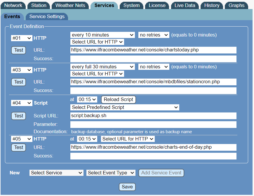

Morning Brian i have been running the new end of day file and i have also done a reboot of meteobridge
new end of day.png (70.1 KiB) Viewed 4779 times

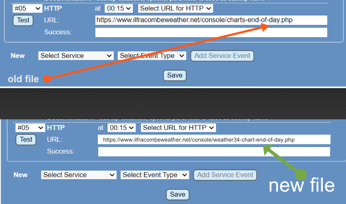

your running the old file change the file to weather34-chart-end-of-day.php
your running charts-end-of-day.php which is the old file.
hope that helps ..Brian
new end of day.png (124.59 KiB) Viewed 4774 times

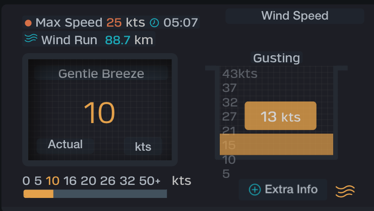

It seems so, I have found a little issue at the wind-max-times who displayed on main-screen:
On Main-Screen windmax-time is 05:07 which is definitively wrong

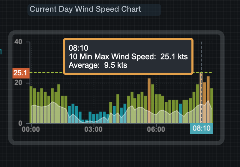

On extra-info-screen the correct max wind-time is displayed 08:10

The other min/max-times which displayed on main-screen seems to be correct, only the wind-values are affected.
I have observed this not only today, also yesterday...
Maybe you can see if you can verify that with yourself?

ok found it its the API which is not something I can correct quickly I have sent a recompiled API to Boris just now Ill push an update when he has updated it . many thanks for finding this .

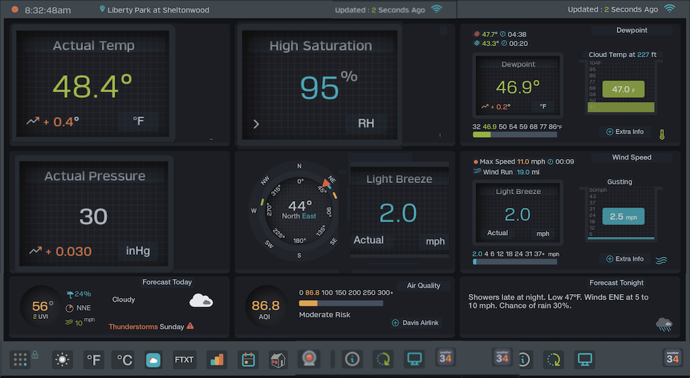

Screen Shot 2021-01-22 at 8.32.48 AM copy 4.png (383.17 KiB) Viewed 4730 times
Second -- and I understand if this might make things unmanageable -- would be to have a new 2x3 template for those modules to be placed into.

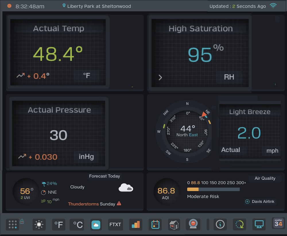

Screen Shot 2021-01-22 at 8.32.48 AM copy 5.png (426.11 KiB) Viewed 4730 times
Anyway, they're just ideas, so I'm not going to be offended if they never happen.

Mike Boris fixed the API earlier so a meteobridge reboot is required for this FIX .
somehow it was overlooked it had
[wind0avgwind-dmaxtime:—]  should have been [wind0wind-dmaxtime:—] my mistake .. :-(
22nd January 2021
*important reboot meteobridge required
* Fixes Wind day max time ref Mike (8:42pm).
* Important update requires Meteobridge Reboot (8:42pm).

Hello Brian,
This fixed it! Thank you very much and good night,
stay healthy!
