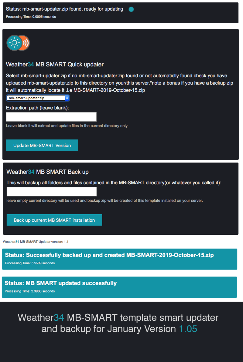

don't worry about updating in the future GITHUB taught or inspired me a lot on how to make things easier for everyone just took time to implement it then make it the easiest way possible and cleanest way, think it turned out self explanatory in the end adding a bit of styling to it makes it easier to understand all-round as it just does two things update or backup. so I have been testing this secretly on two bath uk and Singapore sites over the last few weeks and my own . in January version updates will be even easier and won't overwrite any existing settings and a bonus back up feature which allows you to store a copy of current install prior to any update .
obviously 1st time users/installation won't benefit but thereafter users/regular long term users will just click a button and it scans for the update zip file :-)
each backup is dated like MB-SMART-2019-October-15.zip
each new update zip file will only contain files/folders required for update i.e MB-SMART-UPDATE-2019-OCTOBER-15.zip

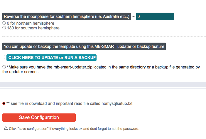

access via the main mb smart setup secure setup screen you use to setup template
Screenshot at Oct 15 18-05-12.png (65.01 KiB) Viewed 9091 times

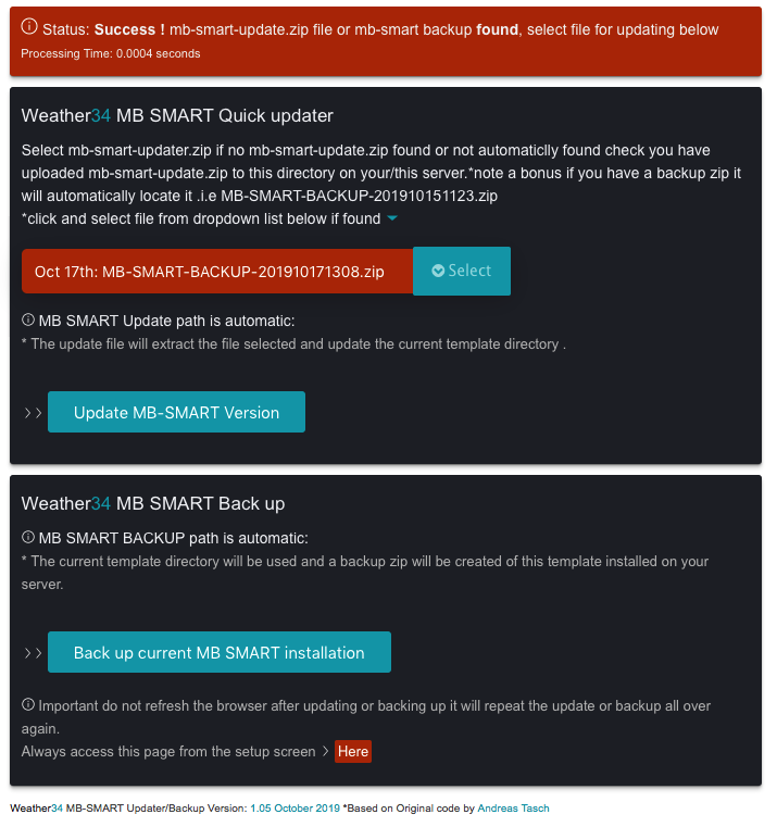

for those that made the request email overnight you should have received a copy of the updater and back up file .made a quick simple guide because it is that easy and self explanatory to use but some might find it useful as a quick reference .but this will be included in January as standard and will be very useful for future updates.
https://weather34.com/homeweatherstatio ... pdate.html

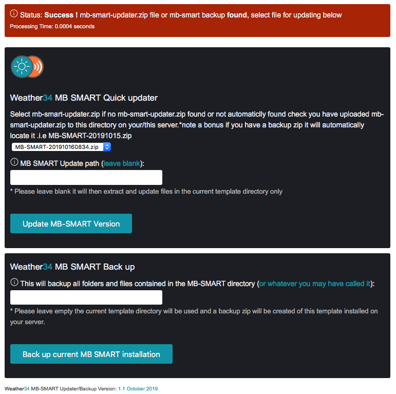

sorry for the delay I have sent out all the requests just now in staggered emails 3 per time so hopefully you can all try it out now.
I added some last minute design changes just to make it bit more user friendly and self explantory I hope :-)
my internet is now limited so I really apologize for not being responsive in a timely manner and probably be like this for many weeks but ill do my best to follow the forum .
screenshot below of how it panned out.

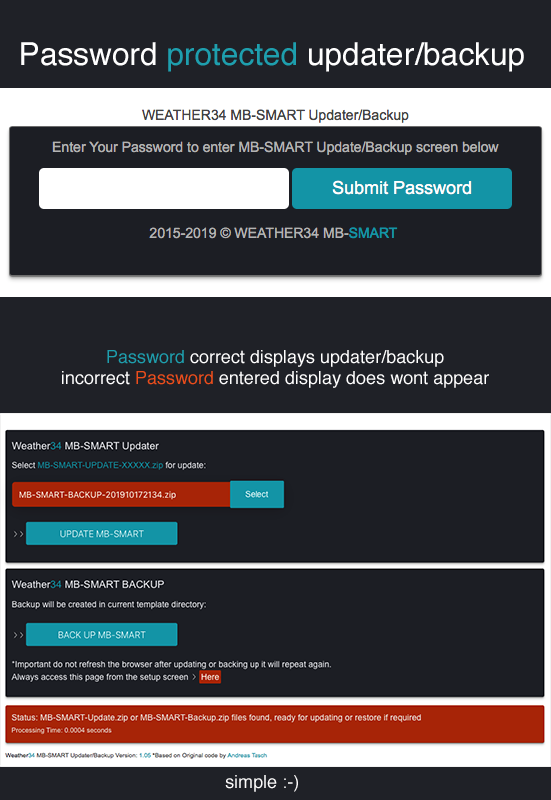

a small addition was added and was sent this morning via email . simply adds a password protected method to updater screen.
