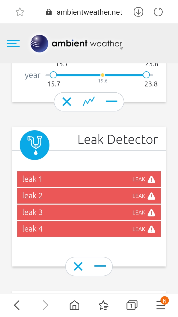

I triggered the 4 leak sensors and the leaks registered on the ambient website and I got 4 email alerts, one for each of the triggered sensors :D
Screenshot_20200612-183015_Samsung Internet.jpg (142.17 KiB) Viewed 4485 times
