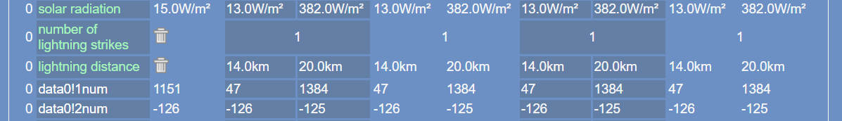

Re: GW1000 + WH57 lightning sensor only - Lightning not showing in MB
Works well on:
SW Version: Meteobridge 5.2 (Jul 15 2021, build 2427), FW 1.3
This is only true in this context, if you have a GW1000 and a WH57 as the ONLY sensor.jmontamat wrote: Sat Jul 17, 2021 10:07 am Works well on:
Otherwise your statement is WRONG in the context of this post.
I can see in the picture that you have at least a solar radiation sensor active, and as they don't come alone, they will come with wind, outdoor temp and humidity sensors. That this works we know since long. See also tests above (#4).
The issue here is that MB does NOT records lightning strikes, when a WH57 is the ONLY sensor connected to a GW1000.
This has been tested and verified - see tests above - and it needs to be corrected in the logger software !
If you just wanted to show that your constellation works fine with MB and the RPi - that's great - but is a bit misleading in the context of this post.
