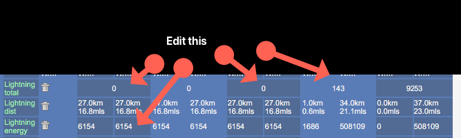

we need it recorded to meteobridge so im guessing 24th march was way before you connected it to meteobridge ?
or edit the live data screen with false numbers and edit out tomorrow ?
Screenshot at Apr 06 19-59-28.png (32.95 KiB) Viewed 4320 times

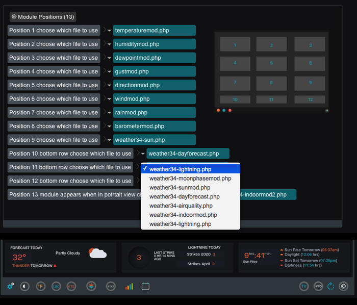

ok pushed 4 files
console-dark.css
console-setup.php
updater2.php
weather34-lightning.php
the path is based on your post earlier mbridge2/MBrealtimeupload.txt
optional setup in positions 10,11,12
perhaps setup lightning charts next week ?
weatherist34 wrote: Mon Apr 06, 2020 8:01 pm ok pushed 4 files
console-dark.css
console-setup.php
updater2.php
Many thanks. I will grab the files. No hurry on the charts - whenever it suits you.
Take care and be safe.
forgot too add you can use the weatherflow app/website go into the charts and calculate year total of strikes and then add it into the livedata screen under year total column..have fun..ps the distance same as all franklin type sensor is an indicator of how near storm is not that accurate just acts as an indication
weatherist34 wrote: Mon Apr 06, 2020 8:07 pm forgot too add you can use the weatherflow app/website go into the charts and calculate year total of strikes and then add it into the livedata screen under year total column..have fun..
Ok I will do that. Just updated - looks great!
