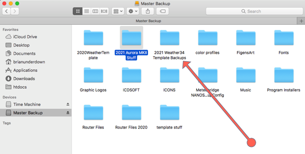

Its worth noting when running backups is to get into some routine of storing these backups on your desktop environment be it hard drive or a back up drive.Keeping the backups on your server will increase the size of backups each time and as noted in a previous post this can dramatically grind your server to a halt if you have multiple backups already on server because the backup will basically add those to the backup your running . so caution there is required and some form of regular routine deleting of backups on server is best practice though don't forget to keep a copy on your desktop environment.
