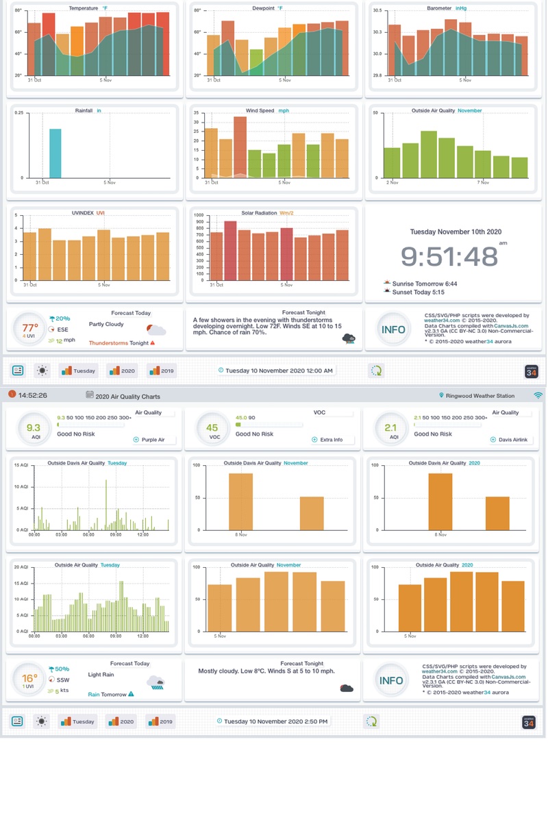

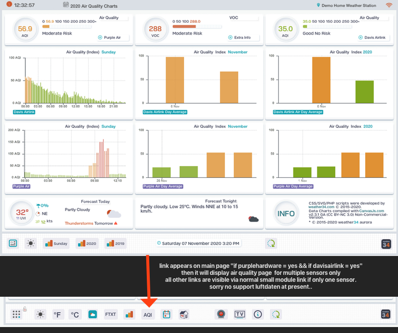

simple update now includes an option to show air quality data page if you have both purple air and Davis airlink if not all data can viewed by existing small module links .please allow a week for the charts for month year to grow and populate at end of each day..
Just uploaded the latest and the new AQI charts page is working great. :D

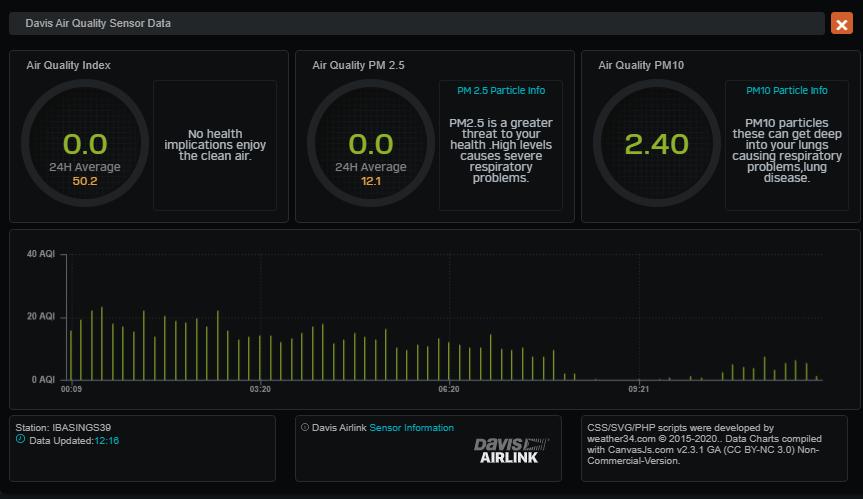

One thing that I have noticed about the Davis Airlink - Using it inside, my AQI will frequently be close to 0 or actually 0. So, I have edited the >0 to >=0 to avoid the NA. Not sure there is a good solution to 0 AQI vs offline.

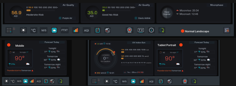

Also, Mobile (Iphone) viewing issue again. Adding the AQI icon leaves no space for the Almanac in Portrait mode, but the Almanac is also missing in Landscape mode.
Portrait:
Landscape:
Best wishes,
ok chuck I have made change just pushed but unfortunately in mobile view there is going to be a compromise just so many different end user configurations to cater for some have everything from air quality,webcam etc some have only a limited standard setup without indoor and so on so in mobile layout for the toolbar at the bottom there is a compromise ...so in mobile view the setup menu disappears as I cant imagine too many set up the template on phone device first time ...
Yes, it is becoming crowded. Removing the setup in Portrait mode is an excellent idea. :idea: I doubt anyone would use it.

Brian, I'm using Aurora and Airlink and it's providing data.
I have not updated my NanoSD to version 5.0, yet all appears to be working in Aurora. If I do update NanoSD to v5.0 will it break the v9.34 of your template which I still have running?

jasonmfarrow wrote: Tue Nov 10, 2020 2:20 pm Brian, I'm using Aurora and Airlink and it's providing data.
Hi Jason,
I think the only thing you are missing is the 24 hour averages. You don't have to have version 5, but you will need to reboot to get the new API values for the Davis 24 hr averages.

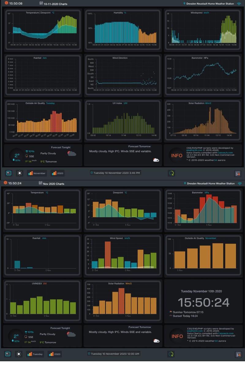

The new chart format looks great :D
@Jason shouldn't change anything I am aware of just a reboot without a firmware upgrade should just pick up new api
@chuck all charts got finally finished far more easier to accomplish without considering languages..there was a lot of chart files updated so might be worth checking you got them all..
