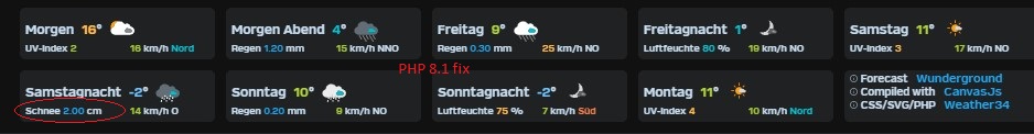

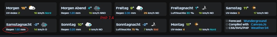

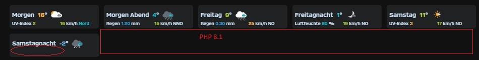

3.) I use PHP 8.1 on my testserver and i found an anomaly with WU-Data, which is not so obvious under PHP 7.4, but snow must be predicted ;-)
In wuforecast.txt the variable snowRange can contain the value "< 2". In PHP 7.4 this is ignored and it becomes rain, in PHP8 the processing is stopped. I removed everything except numbers with this statement and then the snow is also displayed (Schnee=Snow, Regen=Rain).
$wuskydayacumm7 = preg_replace('/[^0-9]/', '', $wuskydayacumm7)
The error surely affects more PHP files of the template where the variable snowRange is evaluated. No problems in outlookwutext.php, it works there without adjustment, what I do not understand.
PHP 7.4.jpg (37.48 KiB) Viewed 6537 times
PHP 8.1.jpg (29.96 KiB) Viewed 6537 times
PHP 8.1-fix.jpg (36.11 KiB) Viewed 6537 times
