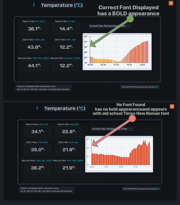

Bart wrote: Thu Mar 11, 2021 7:03 pm Thanks Gary,
Ik did copy the files this way. The date of the files on the server changed. So that's ok. But the date in the window "Weather34" (where you seecheck for updates) is still "Aurora MKII 10th March 2021 Stable Release". Maybe someone can see if my site is up-to-date now? :shock: :? :lol:

good morning
I think this is something locally on server side and likely all about permissions which can be tedious to check. also the permissions may be changed due to desktop environment settings also so .
I have just tested the simple update for the 11th March on Lars server at https://singaporeweather.info/ which he gives me regular access has his data is always an extreme due to his location in Singapore , it gives me a real good look at scenarios glad to say it ran and updated correctly without any issue .
The tell tell sign for recent update not running correctly is in the chart font see screenshot of correctly updated and not updated .

Hello, well they say never give up. Although everything was already fine. I downloaded again this morning. Zip now had file right 777 without my involvement. Installed over the already updated files. Now the date is right, "Aurora MKII 11th March 2021 Stable Release". Looks like something changed on the provider side last night. Thanks for all the patience Brian and have a good time. Stay healthy and safe.

Bart wrote: Fri Mar 12, 2021 12:45 pm Hello, well they say never give up. Although everything was already fine. I downloaded again this morning. Zip now had file right 777 without my involvement. Installed over the already updated files. Now the date is right, "Aurora MKII 11th March 2021 Stable Release". Looks like something changed on the provider side last night. Thanks for all the patience Brian and have a good time. Stay healthy and safe.
Bart
Hi Bart
I too struggled to reliably make the date in that text read correctly after a successful update.
I consulted His Masters Voice ( Brian) and he immediately said “cached web pages” so now after an update I go into the browser clear the cache and go back... That now never fails for me.
If it doesn’t update then when I look on the web server, I always find as well as the update zip file
, a normal folder with the identical name of the zip file.
That folder contains all the files and folders that Brian has zipped up.
It is as if the the extraction routine has completed early.
I was until yesterday convinced that this was due to permissions on the zip file not allowing it to run correctly as triple 7 thing I hadn’t had a single failure.
I’m now at a loss to explain.
