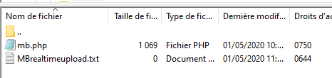

. /mb.php?d for two site ok "success"
i have a txt file which is saved
the contents of the? d =
?d=01/05/2020%2012:00:21%2010.8%2090.0%209.2%201.3%203.6%2016.0%200.0%208.0%201002.7%20295.0%203%20m/s%20C%20hPa%20mm%201.3%201002.7%208.0%20291.0%206.0%2021.9%2045.0%209.6%209.2%2010.8%2020200501115835%208.1%2020200501080124%202.7%2020200501075634%206.3%2020200501103041%201003.5%2020200501003937%201002.2%2020200501100039%204.3%2013444%204.0%20CARAMBOLA2%20--%204.3%2010.0%20719.0%20283.0%200.0%209.2%2020200501115835%206.7%2020200501080124%2010.1%2020200430024943%2013.5%2020200418132225%20-10.8%2020200325143059%204.8%2094.0%2020200501074154%2085.0%2020200501000006%209.2%2020200501115835%206.7%2020200501080124%209.8%2089.0%208.1%2022.1%2045%201.5%201.7%20--%20--%20--%20--%20--%20--%20733.0%207089%2013.8%2020200430141023%209.3%2020200430105932%2010.8%2020200501115835%208.1%2020200501080124%2025.1%2020200409165926%20-2.4%2020200122081856%207.2%2020200430081302%206.3%2020200501103041%
please move to another thread .. clearly your meteobridge pro is having some problems outputting the data string

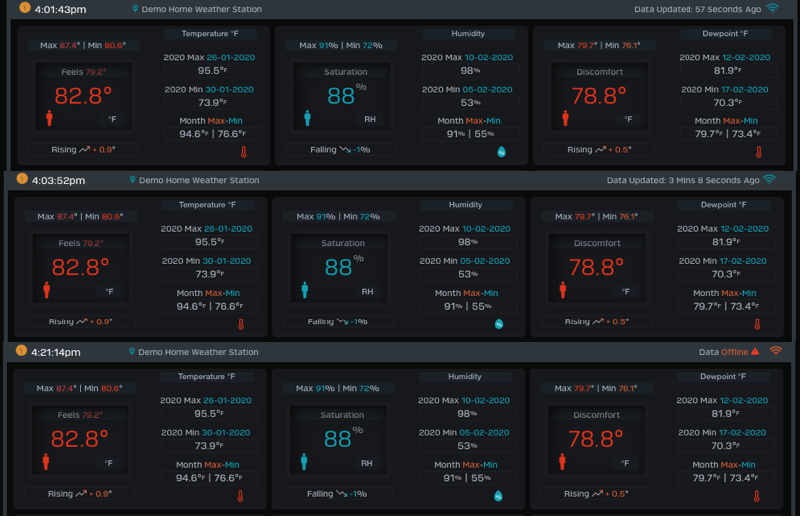

weatherist34 wrote: Fri May 01, 2020 10:05 am @ xxvincixx
does this work for you not perfect but this derives from the time the meteobridge file uploaded/updated to your server .
let me know .
If you decide to add the data refresh time, I would suggest replacing the time on the left with the refresh and leaving the Station name on the right.
Just a thought, since the refresh time would be close to the actual time.
Re: Weather34 TEMPLATE
ha I just saw your post but earlier I had written a small script to show time ago like this.perhaps this is something better than nothing. thoughts?
weatherist34 wrote: Fri May 01, 2020 3:27 pm ha I just saw your post but earlier I had written a small script to show time ago like this.perhaps this is something better than nothing. thoughts?
Got it. That will work fine! :D
ok good so ill add the translations a bit later and ive tweaked it a bit to reflect better when seconds are less than two seconds so it shows second 1 second :D . always something good comes along its what like about ideas cant always do exactly but most of the time can find something that is similar and doesnt congest the display.. many thanks..

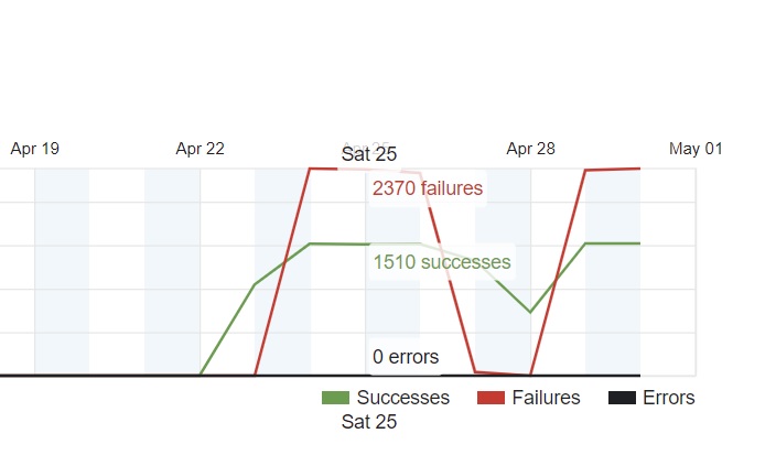

Hi, Brian! Please tell me: I have the latest version of your template installed, and the key from my WU account was copied to the template settings. The forecast from WU stops being displayed in the evening, and everything is normal for the next morning. I couldn't find any information about this on the forum. Here I also attach a screenshot (API Key Usage) from my account in WU.
alexeysailman wrote: Fri May 01, 2020 5:34 pm Hi, Brian! Please tell me: I have the latest version of your template installed, and the key from my WU account was copied to the template settings. The forecast from WU stops being displayed in the evening, and everything is normal for the next morning. I couldn't find any information about this on the forum. Here I also attach a screenshot (API Key Usage) from my account in WU.
do you use the wu api key in any other templates ? how frequent are you telling meteobridge to update/ping the stationcron.php recommended every 30 minutes . i know others who have multiple templates they no longer use but dont disable the calls to various templates still left on there servers and they max out the calls or get blocked for over useage. there is nothing in the template to force updates it get its instructions from the meteobridge request . my guess wunderground unreachable or some server unable to perform the action. same wunderground script as it was in 2019 no changes have been made to how it handles wunderground forecast data. but its wunderground and anything can happen without any indication or possibility of resolving.
so check intervals , server logs and so on.
alexeysailman
Posts: 87
Post by alexeysailman »
I checked the meteobridge settings, what can I say? Now that I'm an idiot, instead of 30 minutes, had put the time to 30 seconds. No wonder WU didn't want to handle so many requests. I changed it for 30 minutes, but I'll watch it anyway. Thanks.

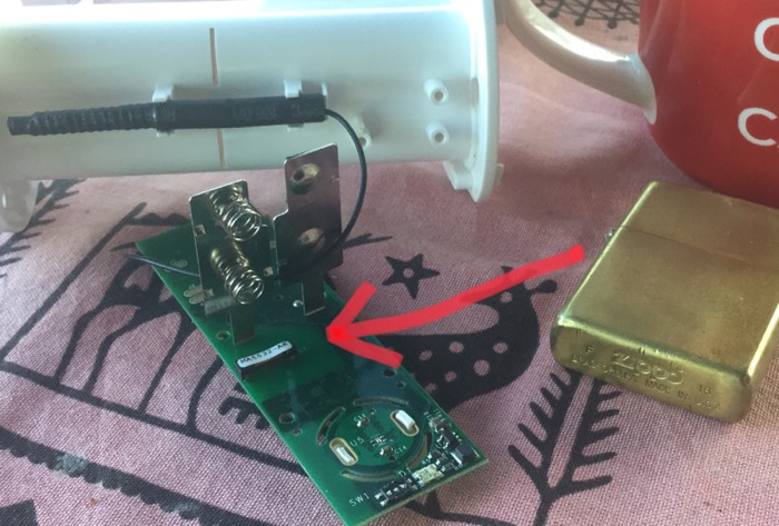

This sensor is the same AS3935 Franklin Lightning Sensor that is used in the WeatherFlow Air unit, I believe. However, its much cheaper via DIY. Brian's method of ground burial might help in a crowded area.
yep identical component slightly different circuit layout ,but here is one of mine I just repaired yesterday its now fully working as lightning detector so I have two to use in opposite directions . However these are very sensitive to man made, machine made, electrical equipment noise I can trigger a strike just by flipping my brass zippo lighter which is what I do to test it . I wouldn't get one or use one if I was living in a more densely populated area .
only other problem you might hit is getting those kit form versions to send data to where you could use it certainly wouldn't connect to meteobridge and be useable on template.hence why I keep the WeatherFlow Air units as they can talk to the meteobridge tp link types or pro
same component highlighted.
