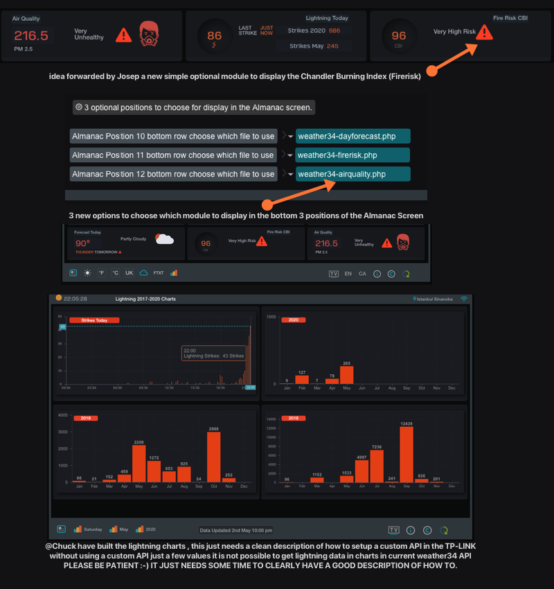

New optional small module added to use Chandler Burning Index -Firerisk, Idea was suggested by Josep so a simple uncomplicated module was made based on his idea/code formula.
3 new options in setup screen to choose which small bottom modules to display in almanac screen.
@Chuck part 1 of lightning charts I have done but needs some proper description of how to use and make a custom API in the TP LINK.please be patient just needs some time to get the how to done that will avoid or reduce the risk of having a messed up API . Basically the custom API has just only 5 values as opposed 172 to send , meaning less processing of data and quicker response !! .
the charts for lightning show current day and annual .the today chart basically takes the value sum of last ten minutes strikes received so you can see the peak times of storm during the day.annual chart takes the monthly running totals as per screenshot .it was fortunate we had our real first intense storm of the season yesterday so I was able to test it the day charts.. 12.8mm(0.51 in) of rain in 50 minutes !!

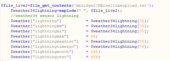

Also, the weather34-lightning.php file in the latest git update inflated my numbers. I looked at the file and it appears to have some constant values plugged in. Perhaps when you were testing

ooops just pushed the original...custom API it is actually only 5 values so it is not complicated todo from end user point .

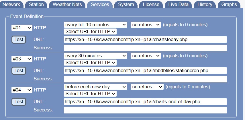

a new process to handle the update of current month and year charts . and brand new file charts-month-year.php to assign.
Charts update end of day for month and year charts
(New for May 2020)
*New process allows to run the end of day at a few seconds before midnight as opposed to old process running at 23:45 ,allows true accurate end of day totals without missing the last 15 minutes of the current day.
Select the Services Tab
1. Goto Select new service
2. Select from the drop down menu HTTP Request
3. Select Perodical in the next menu
4. Click Save at the bottom of the screen
5. Now look for new HTTP request
6. select "before each new day" (it will run at a few seconds before midnight)
7. NOW INSERT THE URL example
8. https://yourdomain.com/console/charts-end-of-day.php
9. now click save .
*the path can be in the root if the template was uploaded to the root directory https://yourdomain.com/charts-end-of-day.php
*if you are an existing user *important remove(delete) the old service that runs at 23:45 https://yourdomain.com/charts-month-year.php
*the old process must be removed if you are a previous user.
(New for May 2020)
9. now click save .

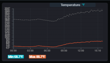

I was just doing your updates and I noticed something on the Daily Temp chart. May have been there before and I just did not spot it. Looks like there may be an issue with the Feels Like Temperature Values. You can see it below. I checked Ron's and his is showing the same.
Take care,
Take care,

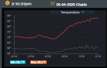

I grabbed your csv data from today so far and plopped it in so hopefully that should look a bit more respectful ..screenshot below and trust the direction words for wind direction are a bit more appealing ? there was also a fix earlier for non metric(Fahrenheit) values forwarded by Josep earlier for the fire risk CBI..

That was fast! Looks like there there may still be a factor off - see below.
Thanks again and no hurry.

try the file just pushed ?
- prestwickwx
- Posts: 510
Re: Weather34 TEMPLATE
OK. That last one fixed it.

After the last update and changes due to the "charts-end-of-day" file, instructions for configuring meteobridge (https://weather34.com/homeweatherstatio ... alone.html) became unclear. From everything it says, it should look like this (mb.jpg)?
Another question: what to do with the file "charts-month-year.php"?

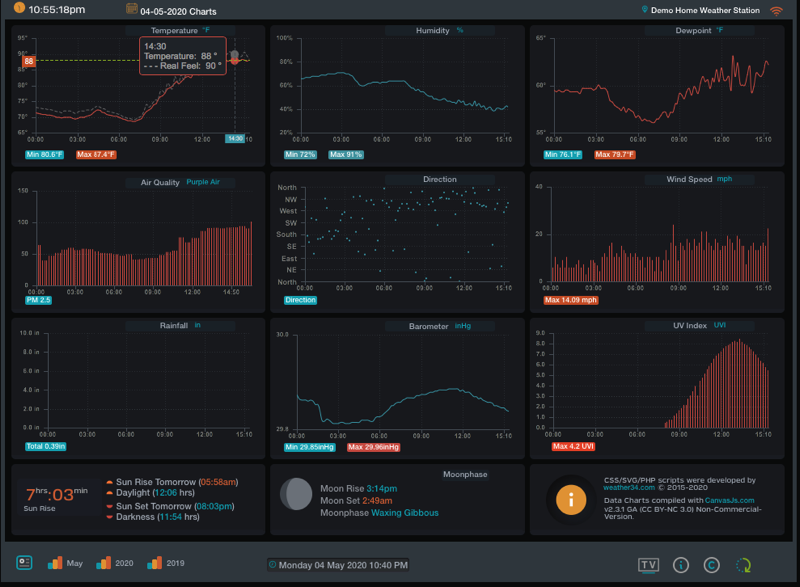

I also noticed an interesting point: after the update, the time counter that appeared in the upper-right corner was reset to zero every half hour. But after my manipulation of the file charts-end-of-day.php the counter started doing this every hour. What does it show for the time, by the way? Interval for writing to a data file?
Speaking of which, in the" desktop " version, there was an update time next to the name of each module, so it was convenient to see when, for example, the temperature was updated, or when the wind or precipitation was. Is this planned in this version?
