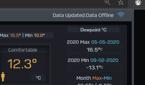

Here is tried the latest update, about support my server sprint - not know. The counter is now completely gone.
Re: Weather34 TEMPLATE
alexeysailman wrote: Tue May 05, 2020 8:34 pm Here is tried the latest update, about support my server sprint - not know. The counter is now completely gone.
tell me which php version do you use/have please also provide a url you url is too long/complicated to get from the image above
I received your pm with password I change the path to simply mbridge/MBrealtimeupload.txt please check now .screenshot of what im seeing now.. paths or just overcomplicated URL I really don't know but simplifying the path to mbridge/MBrealtimeupload.txt worked in the setup screen.you can change the password back now..have a nice evening..Brian

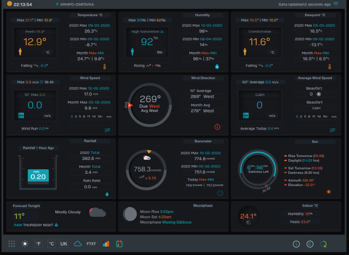

Thank you very much, Brian, the timer works, but every time you reload the page, even without clearing the cache, the timer resets and counts down again (you need to click on the page preload several times). So this is still the time interval between writing to the database?
your reading too much into it , its just reading the time the file MBrealtimeupload.txt was last updated to nothing complicated and template does not use any database . just a simple difference between now and time file was updated ..im on your site now it fluctuates between 0 seconds to anywhere upto 10seconds which is what you want , if it starts showing minutes then its not updating very quickly. no need to refresh page its automatically done

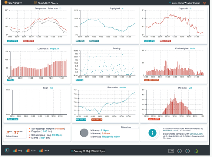

Just please don't get mad at me for asking so many questions :roll: Another one :oops: : when you implemented the mmHg column in the atmospheric pressure module, there seemed to be plans with a note "to do" on the implementation of this dimension in the graphs as well...

please run the simple update dated 06-05-202 available via
quick resolution added for you has your the only one i know who uses mmHG
* note works if position 8 is selected to use mmHG module all barometer charts will show data in mmHG.
*other minor additions and small changes nothing significant .
screenshot with mmHG data in charts

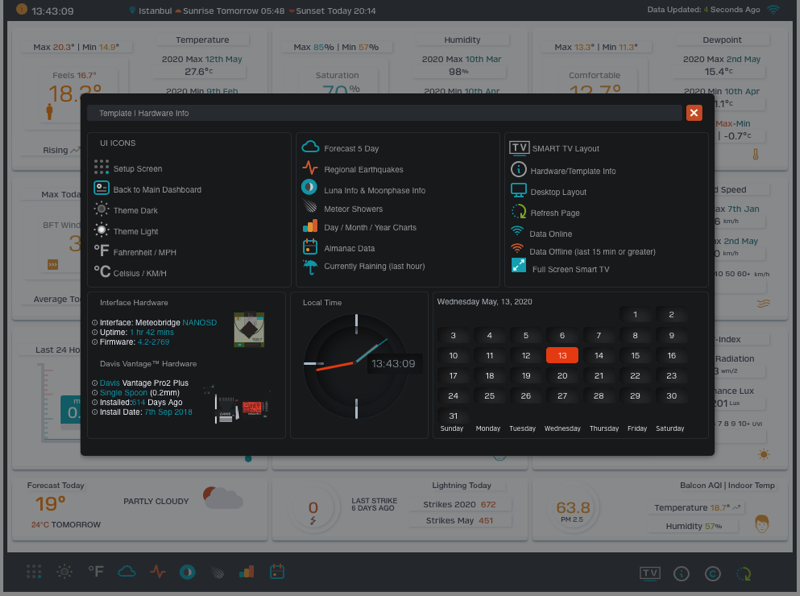

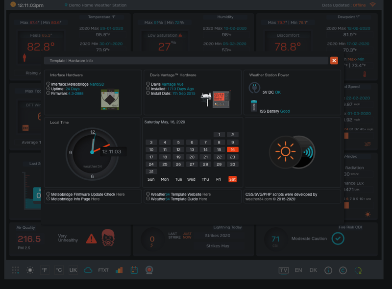

good morning thank you just a minor change this morning to it so it truly reflects local station time if visitors click on the info pop up. but it was based on a dribble design I saw a last week so I thought it would be a challenge to turn it into a web use clock .downside of dribbble its all about graphic design not web design code so it often comes out somewhat different . for those who are curious Ron is talking about this
good afternoon finished adding the two features nothing significant just an idea polished off , a clock and calendar neither do anything other than display date and time .. (languages will come later still finishing off our home network).
simple addition can be installed using the simple update file dated 13-05-2020 via the setup update screen.
hello Good afternoon some minor info
Firstly many thanks to Jason Farrow he has taken the time to recompile the css code to make the Standalone version compatible in viewing on Raspberry Pi 4 800x400 screen , this will be available probably middle of next week as a separate download specifically for Raspberry Pi 4 .
screenshot
The info page for Standalone went through some daily changes to try and find something with the right balance and not congested information the final outcome reverted to a very simple basic layout screenshot. the simple update (16kb) Standalone-update-16-05-2020.zip file has the relevant files .update is only 16kb . via https://weather34.com/homeweatherstatio ... alone.html
