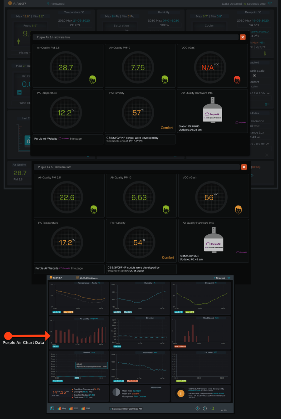

I have added the Purple Air option screen to the simple update , I was also able to use Grahams(Ringwood UK) data also has his purple air has no VOC capability so the fallback is a simple N/A display as shown below .this makes the optional screen available to use for all purple air hardware owners as shown below. if you need chart data for purple air it has been there for many months as an option as shown below.
simple update 30-05-2020 via https://weather34.com/homeweatherstatio ... alone.html

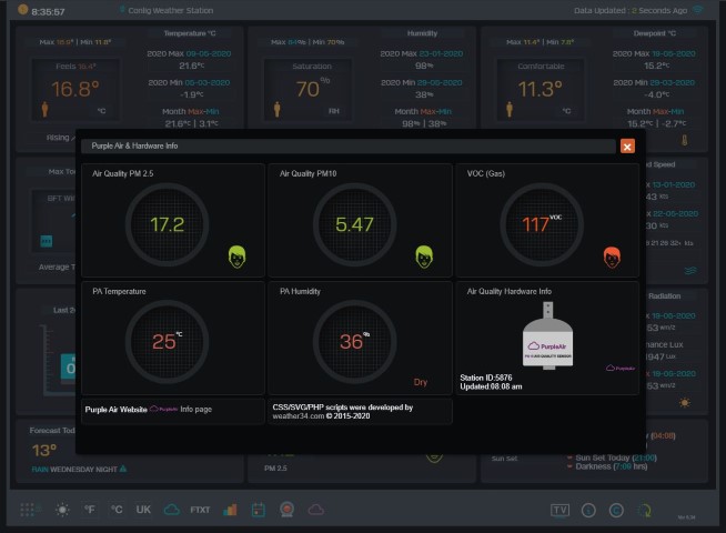

VOC working as shown here:
Capture (Small) (1).JPG (58.89 KiB) Viewed 5644 times
Re: Weather34 TEMPLATE
i think the some research or reading needs doing on the scale factor for VOC obviously very different from pm scaling .
i.e what VOC reading is in the safe limit to what is deemed as concern,dangerous,life threatening etc..

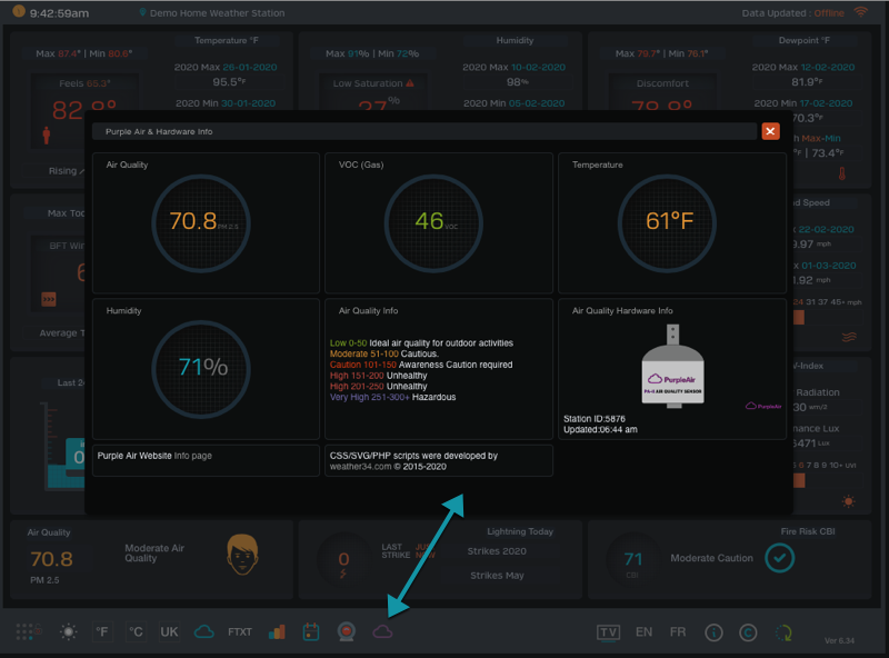

I noticed your new Purple Air screen - nice addition. The module has a links to the Purple Air Website - they presently point to your info site. Not sure whether that was intentional or an over site.
Also, for future updates, I do think your earlier version (below) which includes the AQI numerical range definitions is great for visitors who are not familiar with the values.
Take care,
as always many thanks :-) an oversight or error on my behalf :cry:
fixed also cleaned up red color which was way to dark on dark background, increased font visibility .
Got it. The grids look great!
I forgot that the small module gives the definition, so the Air Quality info I mentioned above may not be needed.

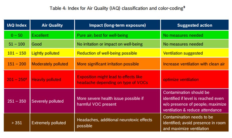

Brian here is some documentation from the BME680 (Temp,Hum,Press + VOC) which is experimental fitting to the PurpleAir Sensor.
https://www.bosch-sensortec.com/media/b ... -ds001.pdf
included in the documentation is Table4: Index of Air Quality IAQ Classification and color-coding
This is for the VOC sensor.

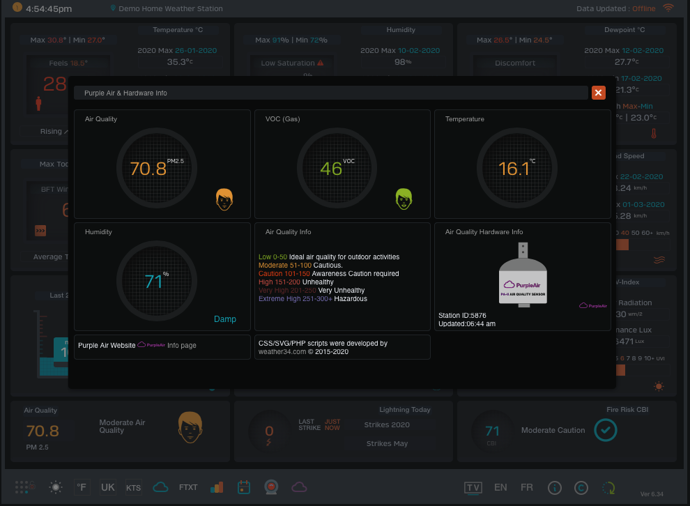

many thanks Simon
have added the color code based on that now , also cleaned up code , cleaned up PM10 formula and other little minor details.
available via the simple update Standalone-update-31-05-2020.zip
think thats job done .many thanks for the idea of VOC im sure some who have it will benefit.
