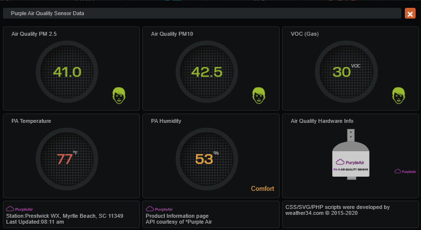

ConligWX wrote: Fri May 29, 2020 6:01 pm Ok thanks Brian. The VOC sensor is experiemental, but from what Adrian has said in the past he will most likely fit the BME680 as standard in the future as this is another "air quality" measurement that PurpleAir can use.
Hi Simon,
I ordered a BME680 from Adrian and I plan to add it to my Purple Air unit to provide another test site. I saw your discussion about the VOC measurement dropping off. Did you determine if it was a bad card or firmware?
Best wishes,
rzelle-K1TTC

ConligWX
Posts: 329
Re: Weather34 TEMPLATE
Post by ConligWX »
prestwickwx wrote: Sun Jun 14, 2020 3:27 pm
Hi Simon,
Best wishes,
Temp, Pressure,Humidity were all working, but VOC was not reporting any result. the values steadied over about a week then slowly dropped off till zero or the value of 25 was listed constantly. the value never changed. I RMA'd the 680, but awaiting supplier to get back to me.

Update - Installed the BME680 and it seems to be working fine. Sent you a PM.

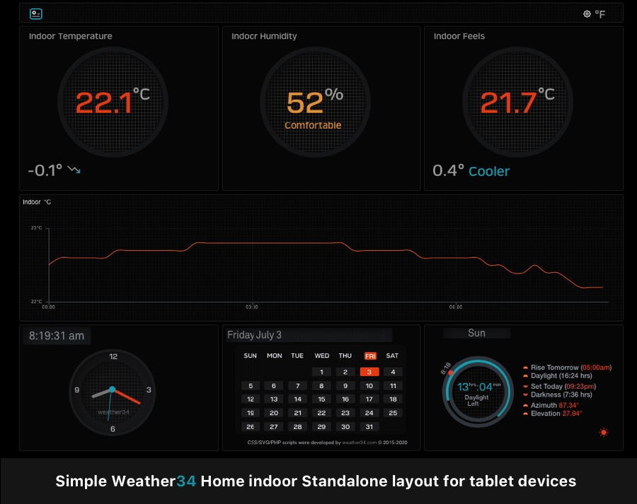

Simple home indoor data for standalone tablet devices it is self contained and ideal for low cost tablet displays in landscape mode only !! with no access to any low cost android tablets at present I cant perfect it for portrait mode .
simply run the (69kb) Standalone-update-03-07-2020.zip via the update screen or if using GITHUB then normal process for updating via GitHub.
the main file is called weather34-ev.php "ev" means home in Turkish :-)
as always via updates via https://weather34.com/homeweatherstation/ or if I have granted you GITHUB privileges to the private repo you can get it via that route.
edit updated late afternoon July 3rd Friday (84KB) Standalone-update-03-07-2020.zip also now has a new moon phase script (very small footprint two updated files weather34-mooninfo.php , weather34-moonphasemod.php)

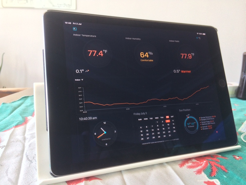

Nice update! Hope all is well :D
rzelle-K1TTC
Posts: 243
Post by rzelle-K1TTC »
Very Nice addition ... Looks Great on iPads ..
73s
..Ron

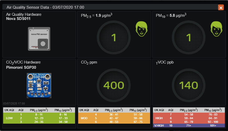

Brian. I hope you enjoyed your time away. I worked on this whilst you were off. My AQI now looks like this:
Both sensors report via the Raspberry PI and upload to mbridge/AQIrealtimeupload.txt and mbridge/VOCrealtimeupload.txt.
If anyone else wants the code (for the RPi or the Template) I can make this fully available.
