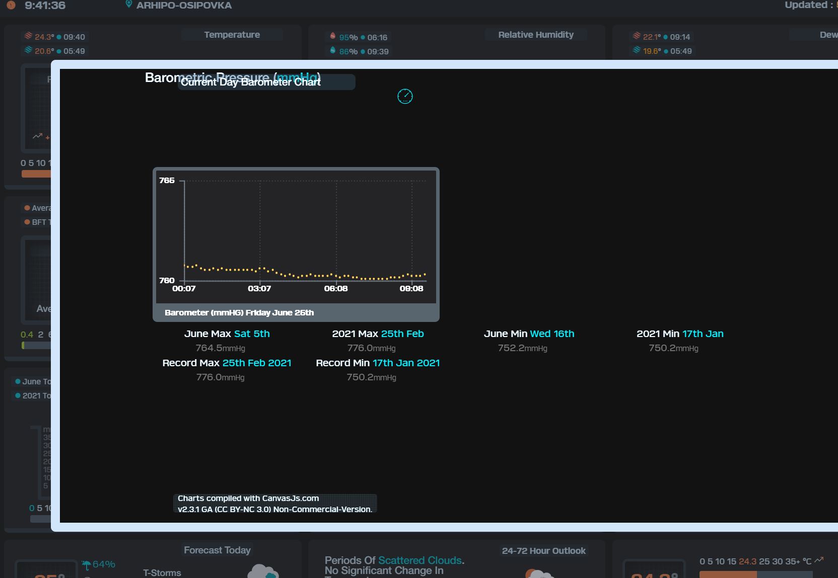

Post by alexeysailman »
Hi, Brian!
Here I found such a thing: when you click on the "extra info" button in the barometric pressure, lines were superimposed in the name of the pop-up window. I understand that it should be by analogy, for example, with the temperature-charts for the current period, month, year?

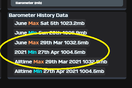

Post by jmontamat »
HI Brian when you can without rushing, a small error in barometer almanac the max value month corresponds to year max.
<? php // year max
echo "" .date ('F')
for
<? php // year max
echo "" .date ('Y')

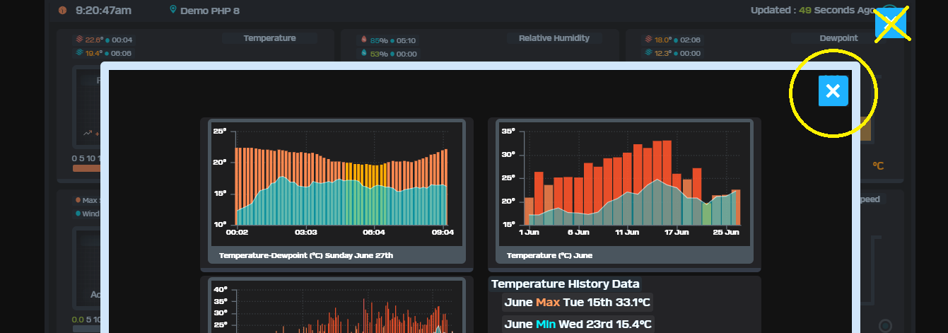

Post by jmontamat »
Hi Bran, as a detail, couldn't the closing button be moved within the popup box like the old one?
Sin título.png (82.44 KiB) Viewed 3953 times

jmontamat wrote: Sun Jun 27, 2021 9:32 am Hi Bran, as a detail, couldn't the closing button be moved within the popup box like the old one?
no problem Josep all done but note Firefox,Safari,Chrome are beginning to render some code differently so beware there may be some minor position difference in these browsers which I can't do anything about.Sometimes I feel we are approaching another period of Internet Explorer differences .Im definitely seeing differences acrosss browsers more and more these days sometimes your lucky just a minor code change but also sometimes a rewrite of sections can occur to find a good balance.
Download Update 27th June 2021
* (16:43) Reposition Close button Ref Josep
* (16:43) Adds preperation code for themeing of chart switching based on realtime theme selection
