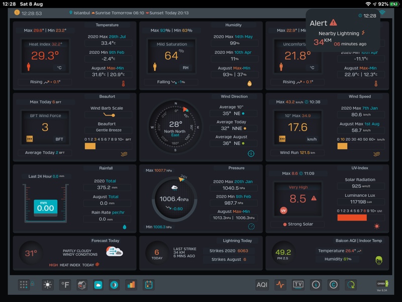

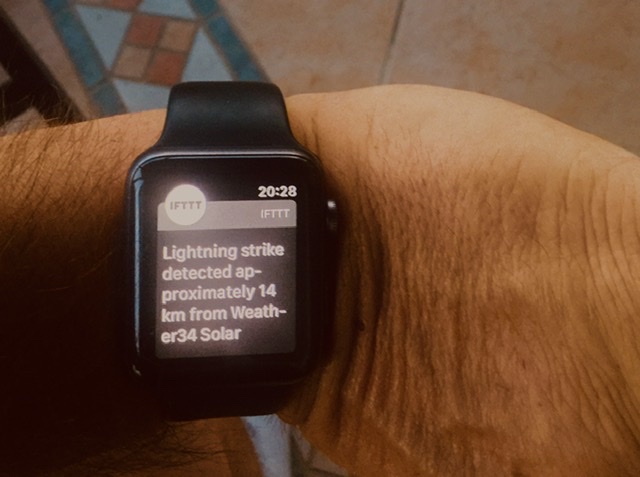

im running two of these Lightning and Rain the notification is hourly not minutes simply strikes can get too frequent when intense, rain tip can be too frequent if intense.
these notifications come direct from the template script and simply interacts with IFTTT .notifications can be disabled in setup screen.
so food for thought but preferably if there is interest I can implement and you need to be familiar with IFTTT setup which is not something I can do from this end .
I have not had any rain for 40 days now so I only have a screenshot of lightning its straightforward no frills just a simple notification.

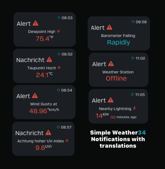

adds new simple redesigned notifications to allow use of translations to be added and easier to maintain.
(447kb) Standalone-update-08-08-2020.zip
(Updated 8th August 09:12 GMT)
* New notification style to allow easier translations use
* Lightning added which is already in the Weather34 Meteobridge API
* Ecowitt Air Quality which is already in the Weather34 Meteobridge API
* Pushed to Version 8.34
* Danish Language updated (Ref Bjarne Riis)
* German Language updated (Ref Torsten)
* Adds new Wind Compass design
* Adds Barometer color balance to Wind Compass
