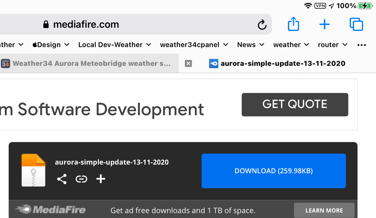

Nice "update": Advertising for Crayford tubes... Something went wrong, didn't it?
Bildschirmfoto 2020-11-13 um 10.01.15.png (195.73 KiB) Viewed 4685 times
best regards
Mike
no idea something at mediafire , correct download worked for me just now .thats an old client from the past ..there maybe more sitting on there ..try again ?
xray77
Posts: 184
Post by xray77 »
it works now correctly, thanks! :)
