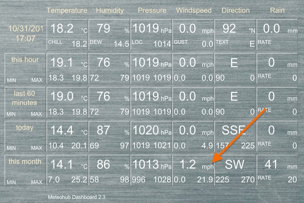

Which settings are you refering to?
Inside Meteohub you can set for the dashboard the units as you want them, see attached screenshot.
The built in WD-live displays the units then also as you want them.
The tags delivered by Meteohub for windspeed also include mph

Hmm not thought about customising the dashboard.
can I add extra sensors to it?
I was talking about the sensors screen, but if I can add extra sensors and change units on the dashboard, I'll do that instead.
