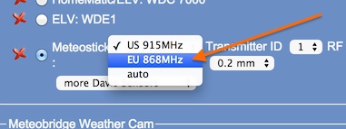

Did you set the correct frequency?
The stick / settings default to US frequency of 915 MH, should be changed to EU. Example screenshot atttached for Meteobridge.

Hi Wim,
Yes, i've tried both, but the frequency i'v now set is: 868MHz
logger (28.11.2014 13:10:20): station 0 (Meteostick Vantage), frequency band 868MHz
Sytze
