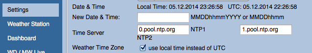

I just noticed a weird problem with the data that my meteohub system is uploading to wunderground. At 4pm (PST) every day (which is midnight UTC), I see the cumulative rainfall get reset for the station. The timezone appears to be correct in the meteohub settings. You can see this problem here

Have you set this flag?
Screen Shot 2014-12-05 at 23.27.50.png (25.07 KiB) Viewed 3598 times

Re: Problem with rainfall resets and wunderground
Post by smackie »
No - that's unset. Is that the problem?
[Edit]
No need to reply to this - I just checked that this appears to be the problem. Thanks for the help!
