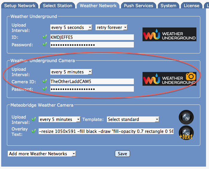

Interestingly, WU has been posting my (too large) photo for almost 24 hours now.
I think we are not on the same page -- I am using the FTP version of the "Weather Underground Camera" on the Weather Network Tab of Meteobridge to upload the photo to WU, not the WU "give us the URL and we will fetch it" version of submitting a photo from Meteobridge to WU.
WU continues to reject my attempts to upload via URL.
So, since I have to use the FTP method to get photos to WU, how do I get Meteobridge to upload the "camplus.jpg" image instead of the "cam.jpg" image?
If I am still misunderstanding how to do this, I beg your forgiveness.

Re: How to get Meteobridge to auto upload "camplus" image?
You cant upload the "camplus" image by WU cam feature. But WU allows you the specify a URL to grab the pic from instead of using the FTP upload technique. I would propose to go that way.
There is no easy way to do this, as the resizing and other image operations are done on the Meteobridge server and not on your client. So the Meteobridge client does not have the camplus image. Downloading this to the Meteobridge client first, in order to send it then to WU via FTP just to work-around a WU bug, that their "load picture from URL" feature is not working reliable, is not a really appealing procedure.
