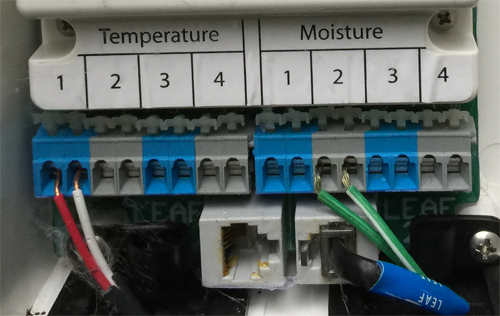

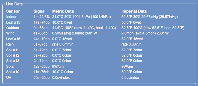

I checked with my soil/leaf station, where I have one leaf sensor, one soil sensor and one temp sensor connected as you can see in the picture below.
This results on an extremely rainy day like today to these Meteobridge live data:
Screen Shot 2014-12-22 at 12.21.36.png (63.06 KiB) Viewed 13881 times
Leaf#15 is pointless, as first leaf sensor port is not connected, but Leaf#16 reading 2nd leaf sensor port reports wetness of 15.
Soil#10 has temp sensor connected to port 1 reporting 10 degrees Celsius.
Soil#11 has soil probe installed to port 2 reporting 7 centibar.
